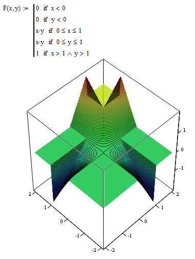

Hello everyone.
I have to sketch this distribution function, but it always ends with this error:
It says that "y" is undefined.
Thanks in advance
Best answer by Werner_E

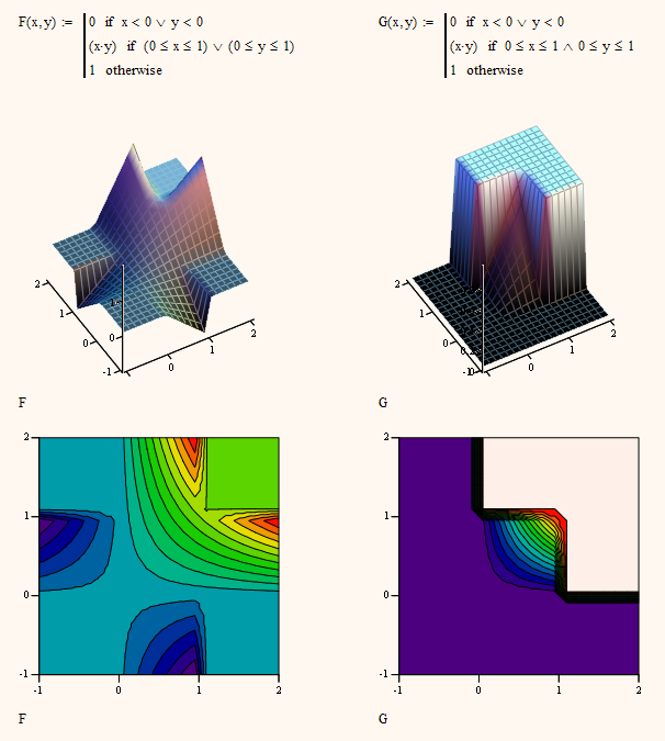

Not sure if your distribution function is defined correctly. Could imagine that you have something like G(x,y) in mind, but then, I may be wrong.
June 6, 2013
Please attach a worksheet (upper right, "Use advanced editor"),
You have a 3D-function (2 independent x,y, 1 dependent variable F) but try to do a 2D plot - use a surface plot.

May by so:
