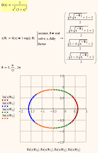

Dependant on the constraints that you impose on the values for 's' there may be an infinite number of solutions.
Given that s=a+i*b you have 1 equation & 2 (potentially) independant variables.
In this case, it appears that the solutions all exist on a circular (?) locus (see attached),
but minor changes could give a variety of shapes.

Interesting approach. Would n't have thought of a 3D plot.

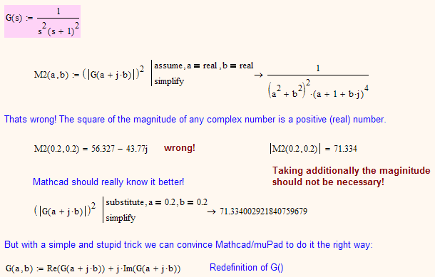

I also played with the s=a+jb approach and simplified the function, splitting the result in real and imaginary part and solving (magnitude=1) for b in dependence of a. It worked but later I came up with a much simpler way.
Here is a simple way to get "all" solutions to the task and the locus looks like an ellipse, the axis lengths sqrt(5) and sqrt(3).
BTW, Alan's solutions are included in this one for theta=0.

I send my sheet and also a pdf printout of it as Fynjy Serg wrote he is using Prime (I won't bother converting it).
I also add my first approach with s=a+j*b and I think I ran into a bug of Mathcad's symbolics - take a look:
