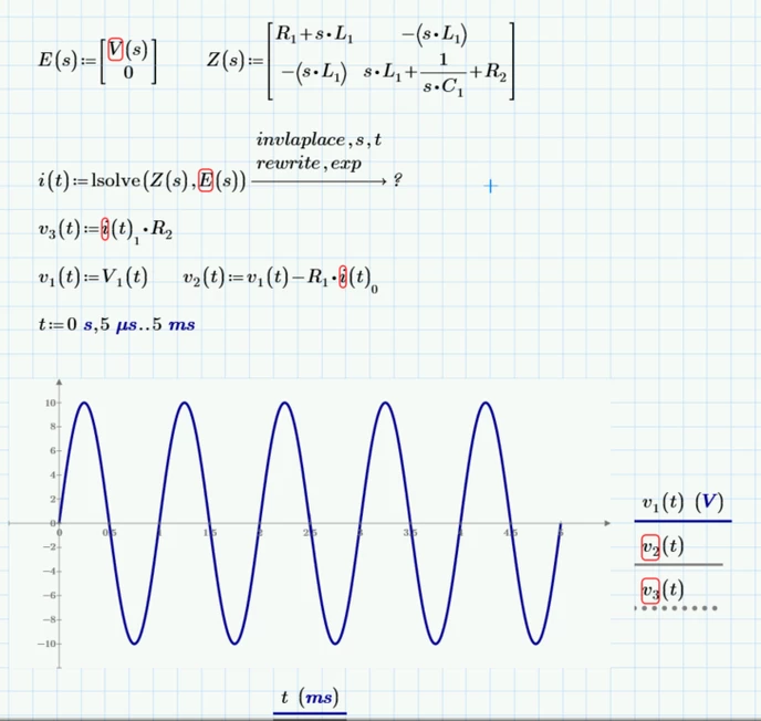

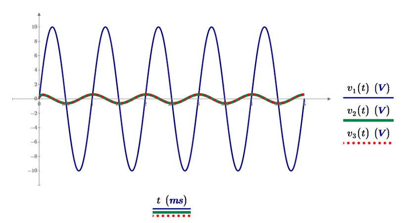

@Werner_E @ttokoro

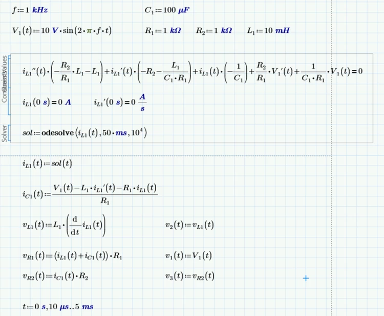

I did not found yet why Untitled-4_MCP10 do not work with laplace, maybe you can have a look.
But I found a way how to do also with odesolve by making more rearrangements....

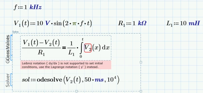

Cornel19-TanzaniteAuthor
Jun 10, 2024 1:52 PM UTC

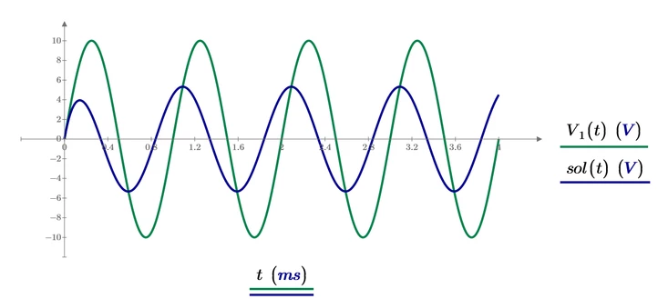

@Werner_E  this to be the only solution, to differentiate in order to escape from integral?
Below solution is for this circuit:

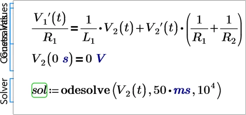

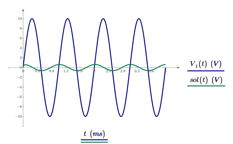

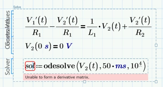

Jun 10, 2024 2:13 PM UTC
@Werner_E @ttokoro
Below is for this circuit: I was expected that odesolve to be able to solve also this simple circuit...differential eq...
Jun 10, 2024 2:18 PM UTC
Ok, I found...
@Werner_E  do you think that is this normal behaviour of solveblock? I mean to arrange V2'(t) like below in order solveblock to be able to solve this differential eq?  In first above case why odesolve block is not able to solve?
Jun 10, 2024 3:25 PM UTC
Looks like Prime is not as capable as we would like it to be.
You may consider contacting PTC support and hope for the best in future versions of Prime.
BTW, the unit of the derivatives is not Volt. It seems to do not matter as long as the value is zero and fixing this does not help in any way to get a solution.
