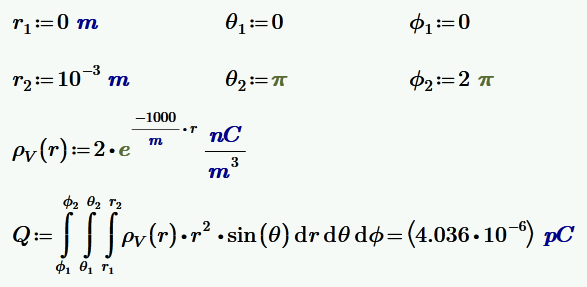

1. I meant to write nC/m^3 as a unit, nanoCoulomb per meter cubic.
However mathcad considers it as something else (variable maybe?)
All the calculations are correct.
What should I do?
2. I should put unit meter m on variable r2.
But if I do that, the calculation goes wrong.
any idea?

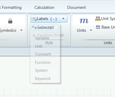

LucMeekesAnswer
23-Emerald V
May 30, 2017
Select the item ( the nC ) and set its label to 'Unit' using the appropriate  item on the ribbon:
Then do the same for the 'm' of metre.
P.S. While you're at it, change the style for the Unit display from italic to upright (roman) to comply with international standard...

bmulyanto1-VisitorAuthor
May 30, 2017
aaah...it is there.
Thank you.
I tried to do right click but it is not there.
Sorry, I am usually better than this.

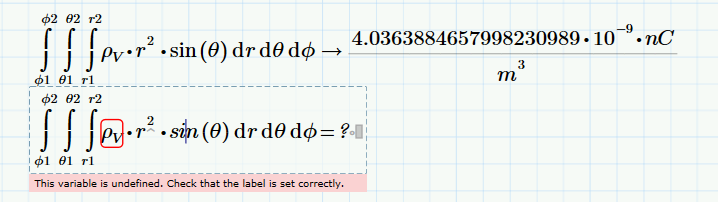

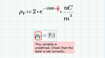

23-Emerald I
May 30, 2017
Okay, you have more problems than you think.
The red circle around the r in the equation for rhoV means that Mathcad doesn't know what to do with it.  So when you try to evaluate rhoV you get:
Then you evaluate the integral but using the symbolic processor.  If you ask for a numeric answer you get:
I've converted rhoV to a function, and added units to r1 and r2; might have gotten the units on rhoV wrong.  See if this helps.

May 30, 2017
I guess its a better view not to say that we must make r dimensionless in the definition of rho but rather accept that the factor 1000 in the exponent must have dimension lenght^-1.

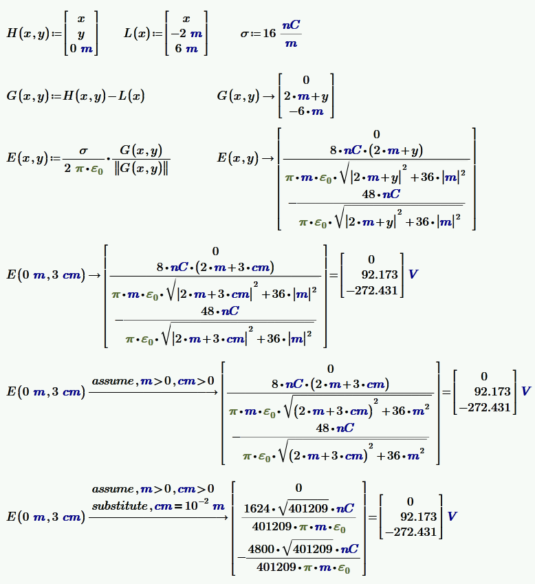

Hi again..
I have similar problem but it is related to a matrix now.
The output matrix become unitless.
All calculations are correct.
May 30, 2017
Its the symbolic engine which does not know anything about units.
If you evaluate your functions numerically (with specific value for x and y) you will see the units labeled as they should be.
On the "Calculations Ribbon in "Worksheet Settings" -> "Calculations Options" you can switch on "Units/Constants in Symbolics" but as far as i can tell is has not much effect. Not sure what this option is for.
BTW, shouldn't it be
or do you really want x to be dimensionless?
May 30, 2017
Correction. The aforementioned option shows effect after recalculation.
The reason you see |m| is because the symbolics still don't understand units and treats m as an unknown variable which could as well be negative or non-real.
If thats a problem you may add "assume, m>0" to the symbolic eval.

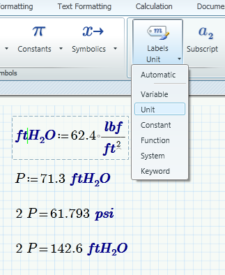

May 31, 2017
I think you need to define the unit, as mathcad doesn't recognize it. For example, I wanted to use feet of water as a pressure, so I defined it in terms matchad recognized;
then I was able to use it:
May 31, 2017
From what I see you did not define H2Oft as unit. So its just a variable you multiply you quantities with.
If you label H2Oft as unit it gets treated colored as all other units for better consistency
May 31, 2017
You are exactly right! Thank-you.
