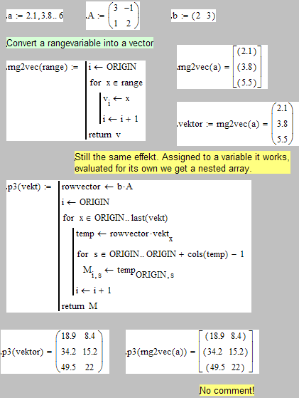

Have played around with your problem and while it looks like I have found a solution, I found myself clueless concerning a specific side effect.
Maybe someon else can solve that puzzle - the behaviour of Mathcad in this respect sute is not consistent.
Seems the lesson is to keep away from range variables other than for indexing.
WE

November 16, 2012
Next try, but still the same effekt:

November 17, 2012
Unfortunately, the ability to convert a range to a vector was not really "designed in". Certainly, not in version 11. So you are right that the behavior is a little flaky. As you note, in version 11 you can pass the function a range value, but not a range variable (i.e. a range value assigned to a variable).
