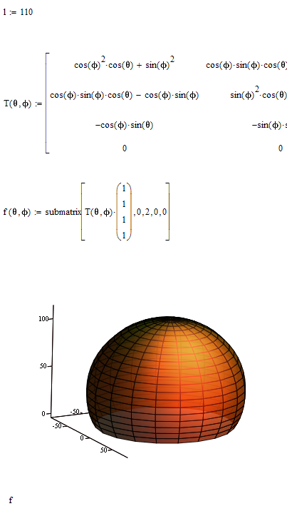

How to use mathcad can draw zhe 3D picture like this
my work is in the attachment , but there is something wrong,who can help me use mathcad draw the 3D picture (the matrix used is shown)
Best answer by Werner_E
T seems to be a transformation matrix for affine and projective geometry (therefore 4-dimensional) which is nothing to be plotted.
What are we supposed to see in the picture?
As a (very) quick hack I graphed the transforms of the vector (1,1,1) and set the limits of the angles as quickplot parameters. Not that nice, i know.

But can you tell me in detail what is meaning of this fuction f() and (0,2,0,0) :QQ截图20130322162910.jpgand how to use the scope of angle
I am not clear ,please teach me, thank you ~
