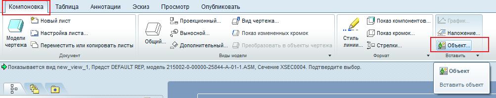

1. Working in the module Drawing (in Pro/E) go to the tab "Layout". And then in the menu "Insert" select type "Object":

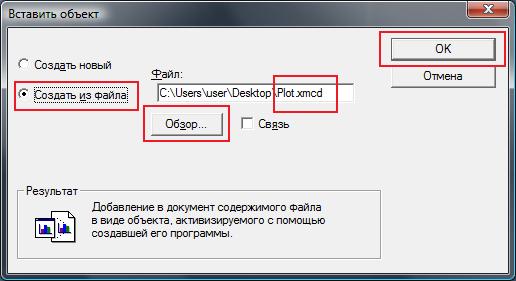

2. In the settings window, insert the object, select "Create from File" -> "Browse" and point to the desired to us file Mathcad.

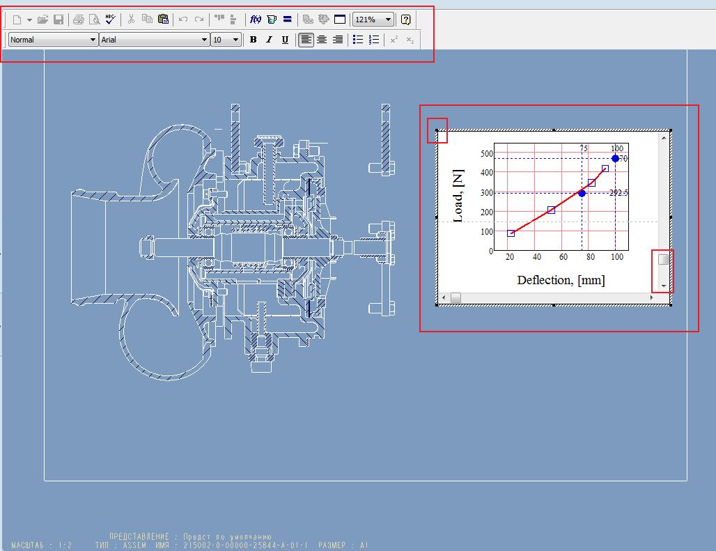

3. Inserted so the object can be edited, and at the same time, activates the panel program Mathcad. Mathcad document is interactive and we can change our calculations, as well as to adjust / resize the display window in a drawing.

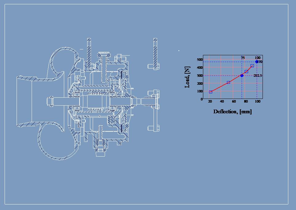

4. The final result for the integration of Mathcad into the document module Drawing (in Pro / E) as follows:
