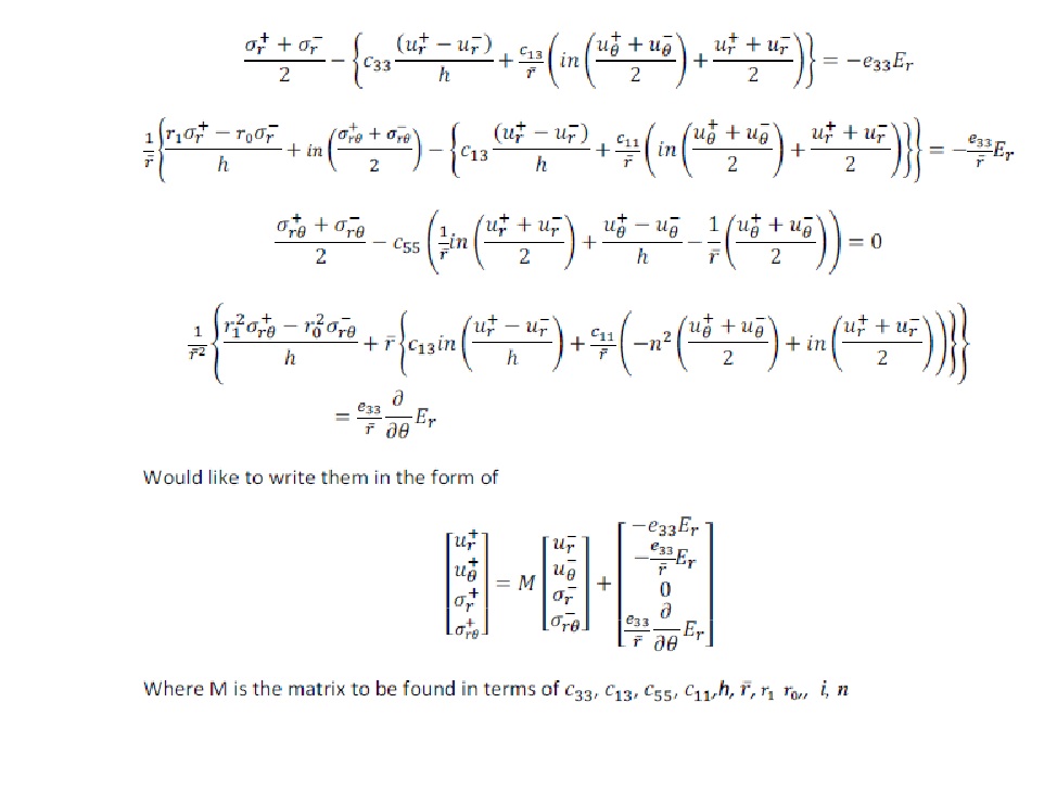

How can I use the symbolic processor to extract the matrix so my equations will take the form

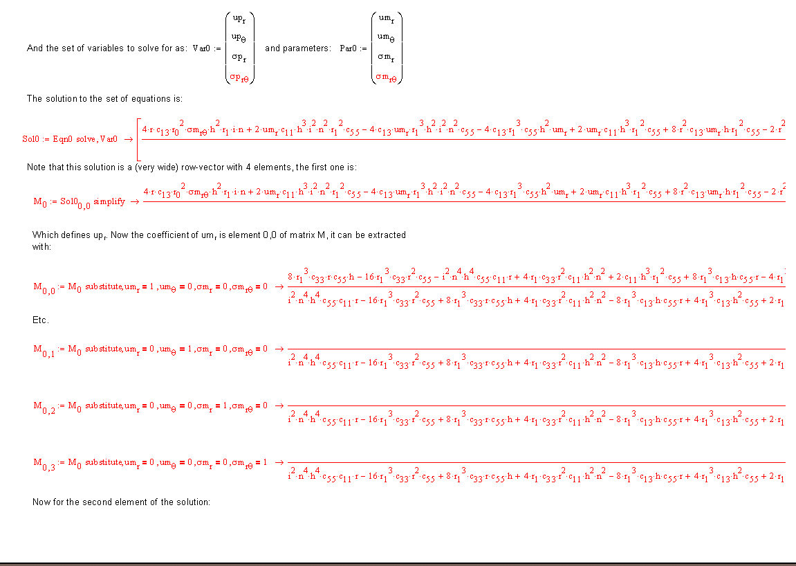

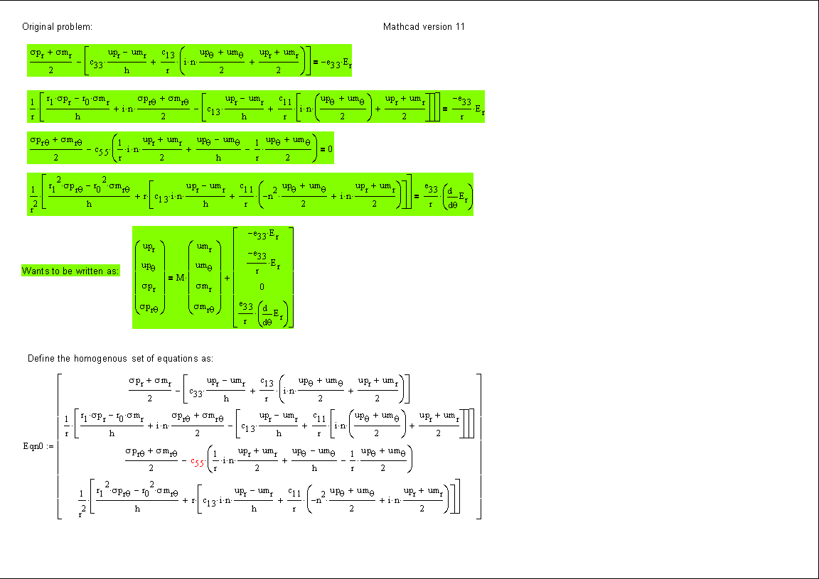

Hi Chad,
Here's my approach to the solution of your problem. Hope it helps.
Note that I'm using Mathcad version 11.
In contrast to Wayne's remark, they do seem to be linear...

Hi Chad,

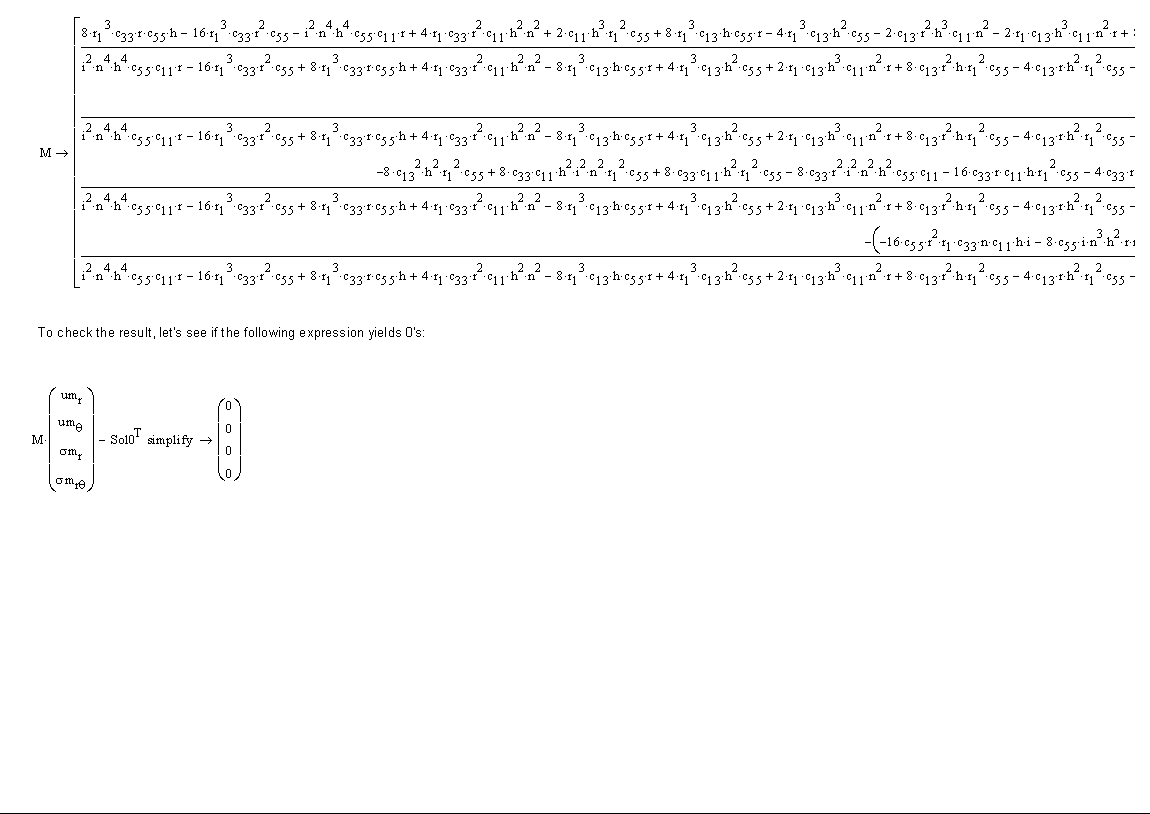

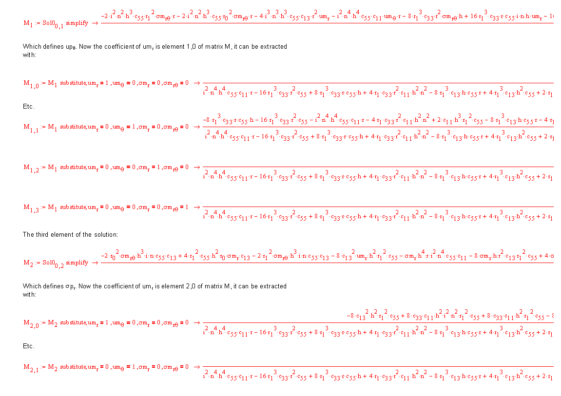

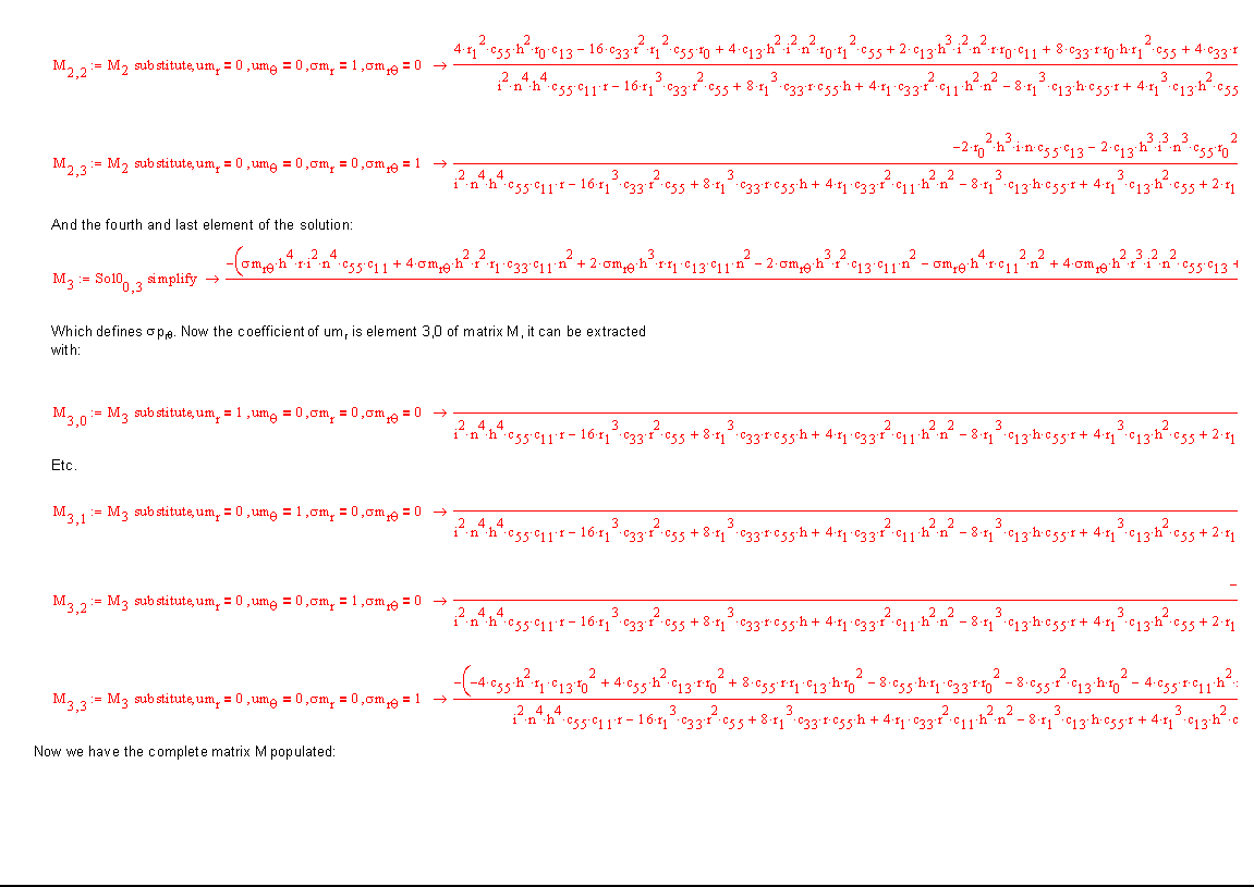

As you can see I've used some weird formula manipulations to actually extract the coefficients. This is because the 'coeff' symbolic instruction failed to provide me what I wanted. Maybe if you rebuild the sheet in 14, with the intention of the method, you can make it to work, provided 14 is kind enough to give asymbolic answer for Sol0..
