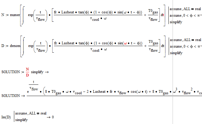

Has anyone seen similar behaviour to that shown in the attached Mathcad sheet? I am losing confidence with the Mathcad 15 symbolic solver and don't know how to proced. Any suggestions or comments are welcome.

Interestingly, I have a complex solution whether I'm integrating with or without the Tgas/Tflow term.
How's the following for a work-around?

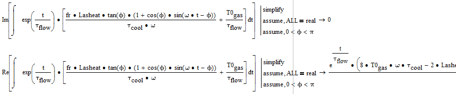

BTW, I played again with your integral and tried to simplify it to track down the problem. While I wqas able to reproduce the effect with a more simple integrand even without that additive constant, I encountered some strange effects during my attempts. Sometimes changing simple things like a variable name would make the i disappear but on relading the sheet it was there again. I also found two workarounds for my simplified example which both did not work on your original integrand.
One way which works for your integral, too, is to separately calculate numerator and denominator and then put both together. Thats somewhat more elaborate than the way with using Re() showed in my earlier post so I would prefer the latter.

Concerning your problem: No! Mathcad does not give you an imaginary solution as you wrote in your file. Just because an expression contains the imaginary unit does not mean its imaginary itself. Mathcad simply had decided that its simplified enough (I also tried "simplify,max" without success). So either Mathcad "thinks" that eliminating the imaginary unit would make the expression less simply or its not capable enough to do so (as seems to be the case here, because the real representation of the solution is shorter/simpler). In contrary to Maple muPad defaults to deomain complex and does not consider an imaginary unit as something bad or unusual
You can verify that its a real solution by taking the imaginary part of your calculation which Mathcads simplifies correctly to zero.
Taking the real part seems to give you the solution in the form you expected.

Werner, I will try your interesting solution with future symbolic problems. I had realized that the term was not necessarily imaginary because it had imaginary components in it. I had even tried selecting the complex result and calculating the imaginary component of it, but got no result.
I tried the solution you had for the integral problem on the non integral problem, but got a “No solution found” for the imaginary part and a “The symbolic solution is too large to display....” for the real part.
