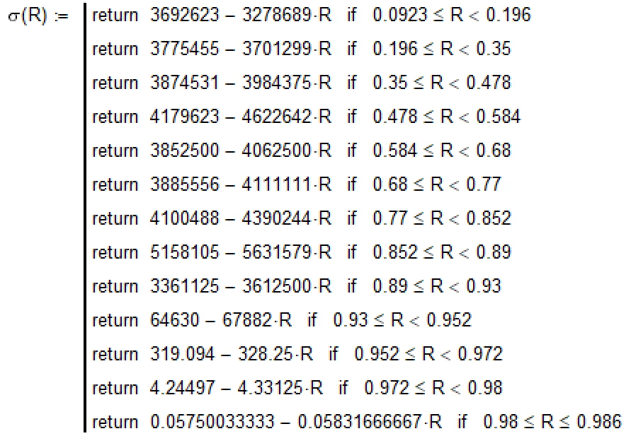

From the very beginning, I was thinking about this Columbian solution, but I expected a more elegant (smoother, with derivatives!).

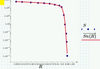

Attached is excel of three fits (curve expert) of digitized data.  No good fits, best fit doesn't roll off fast enough, others go negative at high R.
(If you send a cxv file of point values, I can try gain. (You've got my email.)
good luck!

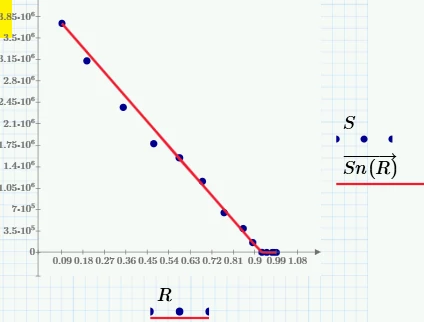

The first points are very nearly a straight line,  So curve can be broken into two parts.  You could possibly get closer to the last eight points with a different function type besides a line.

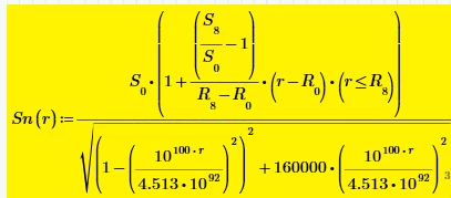

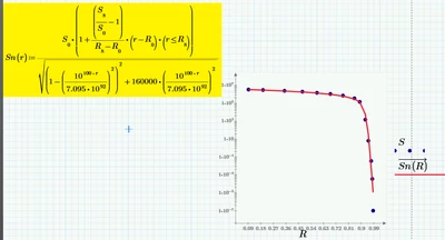

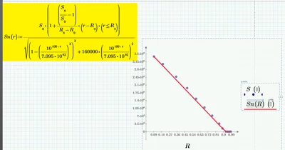

Your plot looked a bit like a low pass filter.
So, with a little sleight of hand. . .
In Prime 4 express

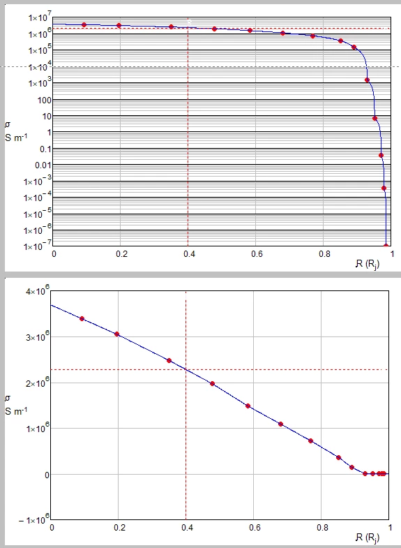

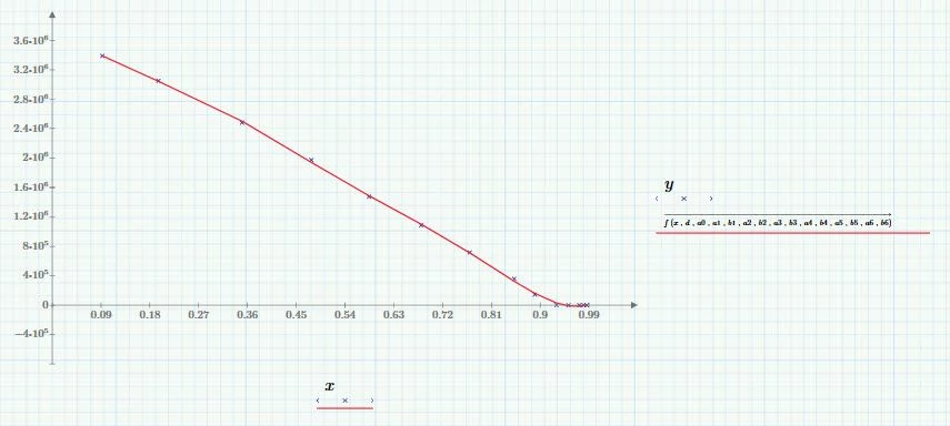

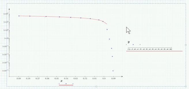

Here's something called Regression Kink Design; seems to be popular in economics.  Does a reasonable job.  It does undershoot the lowest points if you zoom in.  I could only go to 6th order since that's when minerr ran out of variables.
Cooooooooooooooooooooooooooooooooooooooooool!

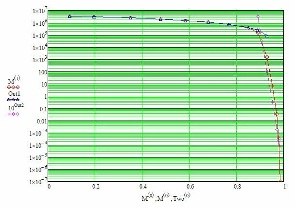

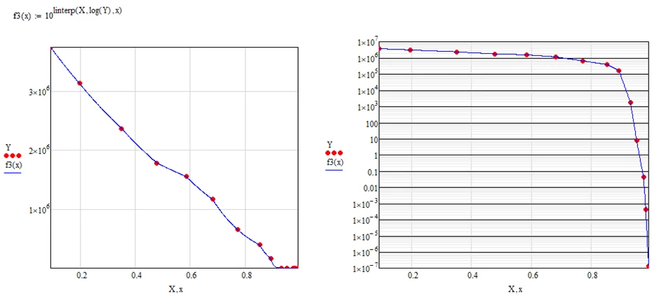

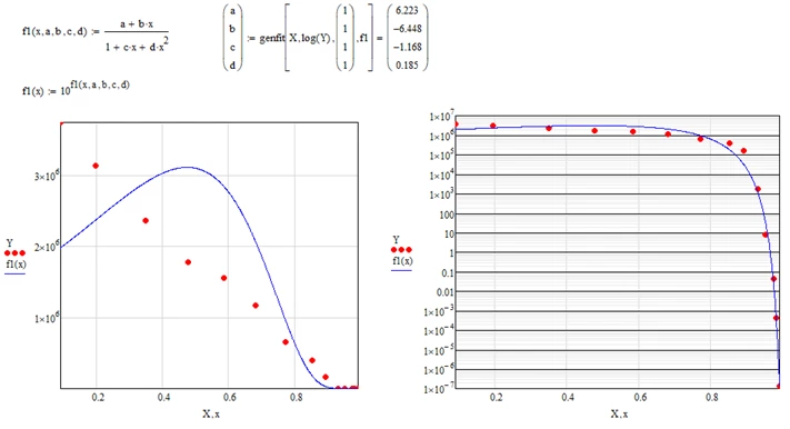

In your initial post you show a plot with the y-axis log scaled. Is this what you need?
Then you have to be aware that the quite interesting solution of DJF will only give you what you need for the first part of your data, similar to what Terry had provided. You would need another function for the second part!

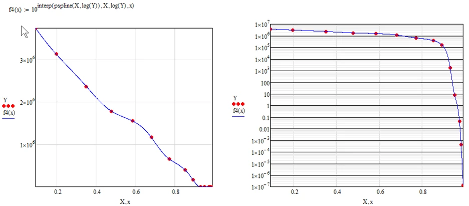

Guess you attached that log-scaled pic to show that you don't like that bumpy look when using linear interpolation, right?
So why not use linear interpolation of the logarithmized data. This should be easy enough to implement in C++ even though its not one single function equation.
You may also use splines, but I guess there's no benefit doing so and its quite a bit more work to implement in C++.
B2.pngHere is an example that a fit (a regression in that case, not an interpolation) which looks quite OK with log-scaled axis, is horrible when plotted without log-scaling.
23-Emerald I
@ValeryOchkov wrote:
Can you show me one formula for this points?
log plotlog plotlinear plotlinear plotdoes not go negative

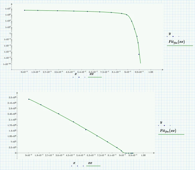

I felt we never got a great solution to this one so I've poked at it occasionally.  Here's an approach that uses Butterworth filters to allow the combination of 3 unique curve fits.  Still not perfect, but an interesting approach to have in your toolkit.  The filters multiply the various fits by a square wave (~1 or 0) to turn them on or off as we progress along the X axis.  In the end it's not much different than Fred's approach, but can help smooth the transitions.
4.0 attached.
