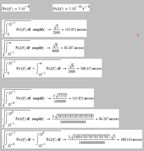

I need help understanding these results. ALl comments & suggestions welcomed. Thanks

I'm sure there's something fundamental that I'm overlooking.
Best answer by Werner_E
When in doubt, ask the symbolics for the exact results. The symbolics does not know anything about units and would treat them as variables, so I omitted them.
July 1, 2013
Obviously a conflict between the way the function is defined and the numerical algorithm used. You get very different results whether you chose Romberg or Adaptive method (rightclick menu).
You get the result you expect if you split the integral at 0.1 Hz yourself.
Werner_E25-Diamond IAnswer
July 1, 2013

July 1, 2013
Werner,
Thank-you very much for your time and help. Your suggestions and reminders about the numerical integration process (both sheets) were very helpful and appreciated. Thanks for the tutorial and pointing me in the right direction.
Jay
July 1, 2013
You are welcome.
Nevertheless its still unclear to me why Mathcad's numerics fails that bad.
Mathcads symbolics wont operate on a function defined by if (neither programmed nor using the if-function).
So I rewrote it using the Heaviside function.
The numerics still fails
