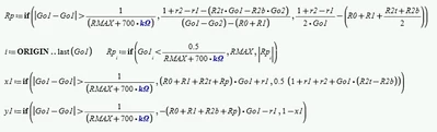

See if this works for you:
I hope I interpreted "+( R0 + R1 + R2t + Rp ) .* Go1" and "-( R0 + R1 + R2b + Rp ) .* Go2" correctly.
Worksheet (Prime4) attached.
Note that Rp, x1 and y1 are mostly calculated as arrays. It's only when the comparison of Go1 with a scalar value has to be made, indexing is needed. (Advice: Carefully read Werner's explanation about vectors, indexing and vector operations here https://community.ptc.com/t5/PTC-Mathcad/multiplying-a-variable-in-a-formula/m-p/716178#M194689 )
