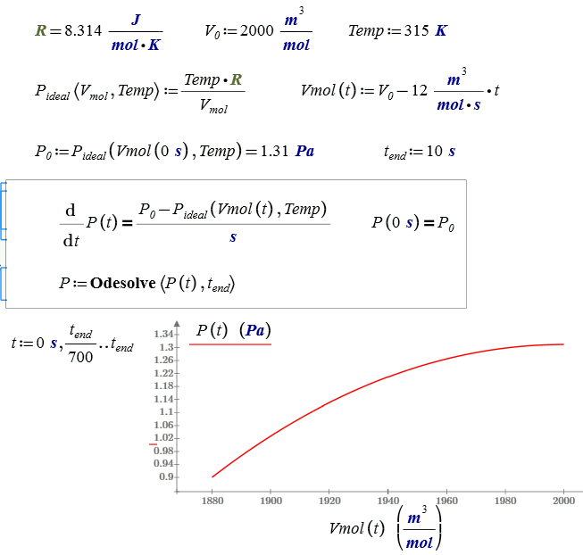

Right now I am working in a small project (just for curiosity, not work related at this stage), and my purpose is to get the final pressure of gas, based on the time elapsed. I have been working with MathCad for several years, but I am not comfortable dealing with differential models. Instead, I always use some numerical methods and/or matrices to get an approx. solution. This time however, I really would like to use the "Odesolver" fuction. so I am using the ideal gas equation (P*Vmol=R*Temp),the initial volume and the temperature,to evaluate the pressure and the pressure profile after 10 sec.
I defined the two functions (Pressure based on molar vol, and molar vol based on initial volume and time), and now I am trying to put them together to get and expression, but I was not able to do it right. Any comment / suggestion at this point would be really appreciated.
I have already finished the mathcad worksheet using a matrix and dt=0.001 sec, but if possible I would like to use the odesolver for this project.
Attached you can find the few lines with the issue.
Additional Question: Does Odesolver support units?
Thanks a lot,
Oscar J.

The initial condition is not given for the function you want to solve (P.ideal != P)
You have a function dependent on V.mol and Temp but you attempt to do the drivative wrt t!?
In MC 15, no
in Prime, yes

Without really trying to understand what you're modeling, I have restructured the problem to solve.
Mathcad 15 will not manage units in Odesolve.
October 14, 2013
Do you need an Odesolver at all here? If you are just after Pideal as a function of time and you have specified Vmol as a function of time, you just need to call Pideal(Vmol(t),Temp) to get pressure as a function of time!
If this isn't what you want then Fred's file should help.
Alan
October 14, 2013
Fred's file in Prime with units. With added sec - what is the physic of this problem?
