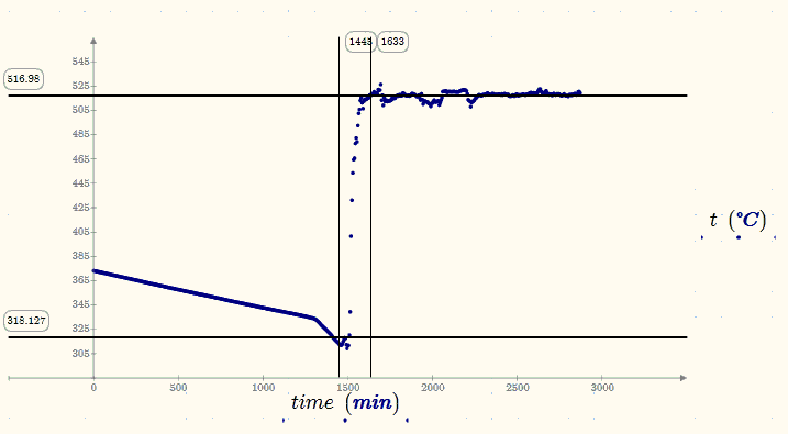

I have started working with Mathcad recently and I have been trying to "filter" my data in order to separete stationary and transient behaviors.
My data is a two-collum matrix with time and temperature. I need to identify the begining and the end of a start up of a system, which will result in an increase of temperature and afterwars the temperature will be stationary.
Has anyone tryed that before with Mathcad??

Best answer by Werner_E
I have added units, as Valery suggested.
Is there a way to avoid having to specify the threshold (temperature difference) in Kelvin instead of the preferred degree Celsius?
Sorry, found it myself:
Added this and edited the sheet to reflect a possible change of ORIGIN in all expressions (the separation of the data in t and T was not ORIGIN-aware in the previous sheets).

I think you can at first to create a plot on your data an see.

As you asked, I am sending the plot of my data.
I had a first experience with Mathcad 14 and this is my first file with Mathcad Prime 2.0.
I was speaking with some colleagues and they suggested that I tried a "moving window" method in which I would check my data for a given instance of time, t, then, I would subtract the value of the t+4 (ie. the data ahead of the one I am checking) of the value at t and if the result is higher than a specified value that I determine, I could identify the beginning of the start up.
Example:
At t=5minutes, my temperature is 300ºC, I would compare it to when t=20minutes (assuming I am collecting data at every 5 minutes) and that at t= 20minutes the temperature is 350. If I set the difference to 20ºC, the filter would have to identify this as the start of my start up.
The thing is that I do not have much experience in programming. Maybe you guys can check if the logic is correct and maybe give me some tips or an alternative way to make this or even any file that you may have done something similar.
