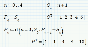

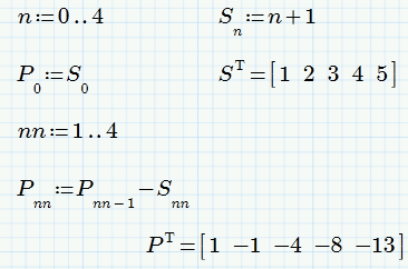

But easy solutions are at hand quickly. Most obvious one is to define the first value in P in a separate expression.
It does not matter what value P[0 is assigned to - Prime just insists that P[0 to be defined. So I guess the problem has to do with the combination of shortcut evaluation of if and usage of ranges - not sure, though.

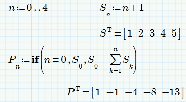

Neverthelesse, shortcut evaluation as you described seems still be implemented in if as the following shows.
So it could have something to do with evaluating expressions with ranges.

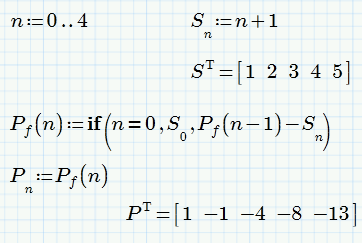

BTW, here is yet another appraoch using a recursive function
