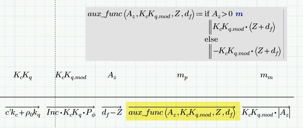

Hi guys i have a tabulated problem of which I am trying to multiply out various terms
There is a column headed mp. as each term is multiplied out there becomes a point where this figure becomes a minus value. At this point i need the equation to change. I have tried an IF statement however because i am working within a table format it will not let me achieve this function.
I was wondering has anyone come across this or should i remove the table element and do this long hand?
Sheet attached
Thanks 🙂
Werner_EAnswer
The main reason you are getting the error is because Prime does not allow to vectorize a comparison operator directly. A workaround is to define a function beforehand which does the comparison and call that function vectorized.
So the vector mp is now calculated as you expected it and could be used afterwards. But the use of a Prime table for doing so is not needed (and does not make much sense IMHO) anyway.

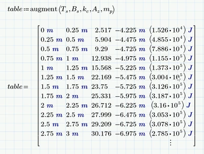

As Fred already wrote a Prime table can only be used to input data vectors manually but is in no way helpful if your goal is to display data.
Prime does not offer a decent way to display data in a nice and clear way. You may create a table by augmenting the data vectors

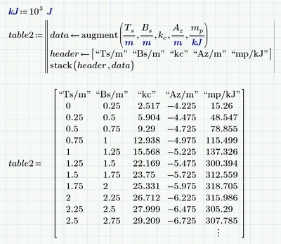

Or you can get rid of the units in the table and add an (ugly looking) header

Werner_E25-Diamond IAnswer
