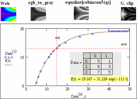

The work sheet is 100%, zoom 125% and see the coordinates not change. That confirms my previous assertion. The project is under construction for other purpose than the QED of my past declaration.
The real project starts @:
Recommended working procedure
Enjoy, comment ...
Jean

I can see a very accurate digitizer, w/o scripted component, convivial enough for the casual user and his tool box.
Hello ! Jason,
... if your ever read this thread.
Your circle is in the bag, but can't be RGB on BW.
Well, maybe it could but ?

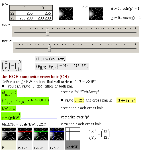

... done,
The steps are shown in term of ImProc functions.
p_to_digitize included for you to continue.
Success, was not expected so easily.
jmG

1. The cross hair tracks the X, Y sliders
2. Each of the preferred color 0 ... 255
3. Geometric forms possible [circle/square/ellipse]
4. APPENDPRN works OK
5. Digitizing within the same work sheet.
6. Extract RGB levels @ coordinates X, Y
That particular project, the Mathsoft digitizer failed !
First time it failed to me.
jmG
