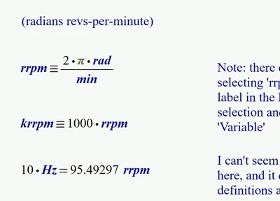

I am trying to use custom units in MCP v11. I have an included worksheet that includes a lot of domain-specific units and functions. This has been carried over from MCv15 and previous. I am now noticing that some of these definitions aren't working - I have distilled everything down to one simple example of success and failure, with no apparent reason why. See attached.
I also tried to do my due diligence and see if anyone was reporting anything similar. Why there are lots of questions related to use of units, I didn't see a similar issue being reported.

I had no problems to change the label of "rrpm" and "krrpm"from "Variable" to "Unit" via the menu.
But I remember that from time to time in the past I had a similar problem as the one you describe - changing the label via the menu did not work as the label would immediately snap back to "Variable" as soon as the focus was out of the region.
I don't know what caused that misbehavior.
But changing the label using the keyboard shortcuts always worked OK.
You can use Ctrl+Q to cycle through the seven label-types or you can use Ctrl+U to toggle between "Unit" and "Variable".

Thanks Werner - I tried the Ctrl-Q/U trick and that worked - glad to know (hope I can remember) - I assume this is documented in help somewhere? As for the disabled regions thing - I agree, it seems that the red box is static once the definition is disabled. I also discovered a difference between the local and global definitions -see updated attachment.

The weird thing is that when I reopened this doc I still saw the stuck label (stuck as variable) and several of you had no problem with this document. So it isn't the file itself??? Does that point to some system issue?

However, I notice that you're using Global Definitions.   The behaviour of these is markedly different from M15.   You can only define a name *once* using a global define.  Unless you have a pressing and unique need to use a global definition, I'd suggest you use the colon-equals definition.

Hi Stuart - I had tried both definitions before and had the same problem (couldn't change a label from 'variable' to 'unit'). However, I did notice something else between the two definitions. See my response to Werner

Providing an update as I continue to explore this. Thanks for all the input and wisdom. I will change all of my definitions in my included 'units' file to ":=", (local definitions). I don't imagine search and replace will work for that? Along those lines, any idea how to do search/replace operations on subscripted variables? Now that the subscript mechanism is not a character (ctrl+'-' vs '.'), you can't search for full subscripted variables.
Here is my new discovery - "including" a file appears to make the units definitions appear as 'variables' to the worksheet that envelops the included file. Here are my two test cases - maybe I'm drawing the wrong conclusion?
