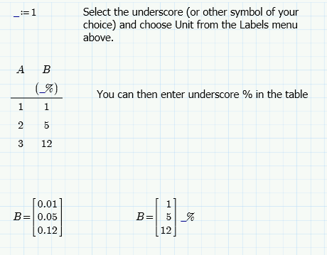

Hello all,
Could you please tell me how do you insert (or make the program recognize) % in the Table unit placeholder on Prime 2.0 ? Thank you
Lawrence
Best answer by AlanStevens
One, somewhat cumbersome, way below:
There is probably a simpler way, but I can't see it!
Alan
8 replies
October 2, 2012
Alan

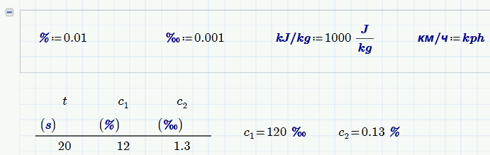

October 2, 2012
You can copy this "units" from the attached sheet:
PS
I know that PTC would like to go back to the old (Mathcad 15) tools of the working with %
