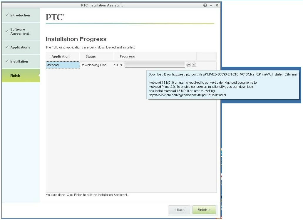

I'm installing Prime 2.0 on my work PC, and I get an error message (see attached jpg screenshot). My computer is good enough, I'm not sure why it doesn't work?
Thanks, Matt
November 2, 2012
Try to use another internet connection.
November 2, 2012
As its a desktop PC and using the company network, I can't take it elsewhere sadly.
Thanks for the suggestion though.
Matt
November 2, 2012
I always have problems downloading from the PTC site. For some reason it always times out, using either Firefox or IE. I found that installing the DownThenAll add-on for Firefox allows me to download OK.
