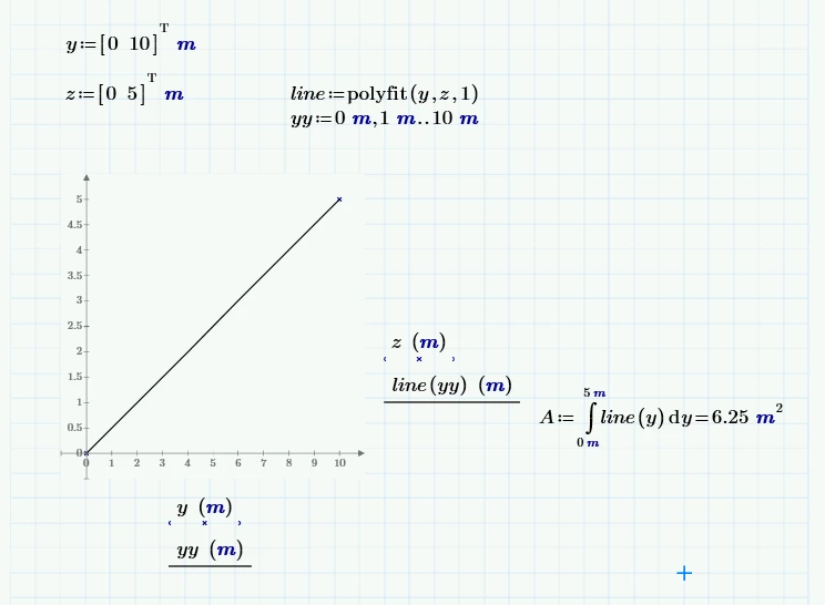

I am looking to see if you can tell MathCAD to integrate not along the x axis by along the y axis.
In the attached I am trying to integrate the area above the plotted line i.e. from 0m upward to 5m integrating all the values of x in terms of y as opposed to the default which is to integrate under the line all the values of y in terms of x. There is madness to the logic as to why I want to do this I promise.
If I can get this to work the answer should obviously be 25m^2.

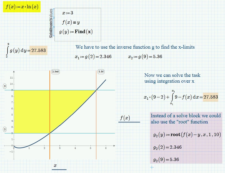

You used an assignment (f(x):=y) in the solve block constraint but you must use a boolean equal sign (the big fat =).
Here is an example where you can't find the inverese function in an exact analytical way.
And even when you try to find the yelllow area using integration over x, you need the inverse to find the x-limits (the same is true for your example, but there the limits where quite obvious).
The picture also shows a way to use the root function to define the inverse.

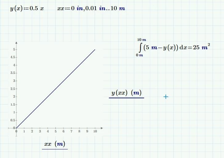

First, you need to integrate from 0 to 10 meters.
Second, your integral computes the area below the line.  The area above the line is the integral of 5 - line(y)

Yeah I know the range 0 to 5 is not going to work as it is currently integrating below the line.
So in order to integrate above the line would the integrand the same and the lower limit "line(y)"?

You're integrating along the horizontal axis!
In this simple expample with a linear function you have a couple of choices and one of the easiest sure is to stay integrating over x and simply integrate the function 5-y(x) fron x=0 to x=10 as suggested by Fred.
If this is only an example and you intend to use a more complicated function, this appraoch may work, too.
Another approach would be to find the inverse of your function (you may use a solve block to define the inverse function) and really integrate this fucntion over y.

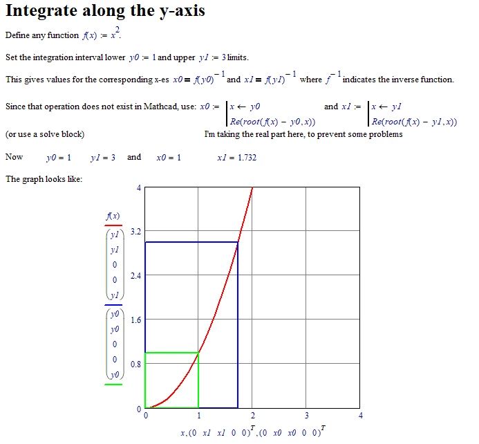

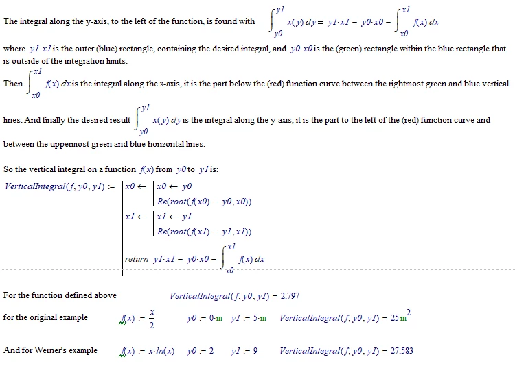

Just for completeness, here's a function to do 'vertical integration' on an arbitrary function (well.... arbitrary..... there are limitations):
I can understand your desire to integrate along the y-axis.  You should go back to your calculus definition of integration.  There is a significant reason to only allow integration along the x-axis.  The only way this can be done if there is a unique relationship between x and y.
Example  y = Mx + B has a unique relationship between x and y i.e. for each x there is a unique y
Example y = Mx^2  This does not a unique relationship, for each y there are two x's that are a solution.
