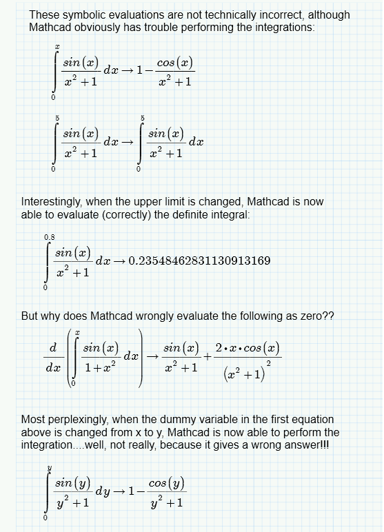

Dear all,
Please help me resolve these confusing usage issues.
I'm using Mathcad 15.0 (15.0.0.436 [006041742]).
I've additionally attached my working as a Mathcad worksheet. Thanks.

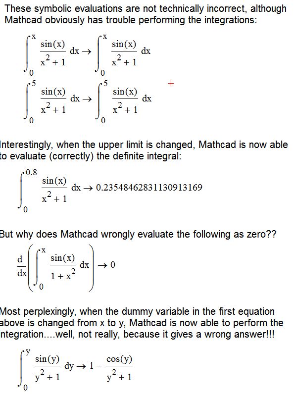

Mupad(the Mathcad symbolic engine) is not infallible and has problems with difficult integrals (and some simple ones!). I'm using exactly the same version of M15 as you, but your worksheet gives slightly different results for me, as can be seen below:
Alan

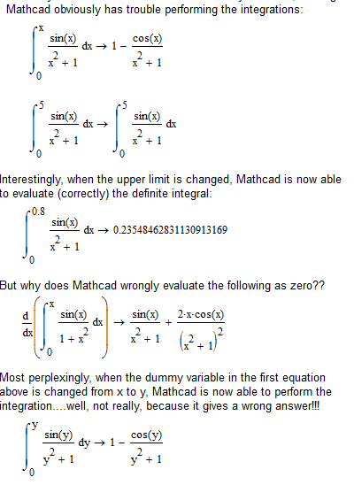

Hi Alan, thanks for your reply.
Okay, I just reopened the worksheet on the same system, and weirdly, my Mathcad is now giving the exact same values as yours (i.e. it is no longer giving the values I originally got earlier on!).
I.e. our copies of Mathcad (including Vladimir's copy of Prime 2.0) all give the same errors.
Please refer to the updated worksheet below (specifically the last question, where I have re-angled the problem):
Thanks!

Ryan Goh wrote:
I'm using Mathcad 15.0 (15.0.0.436 [006041742])..
This is a F000 service release of Mathcad 15. And I have the same result as shown by Alan (use Mathcad 15 M010).

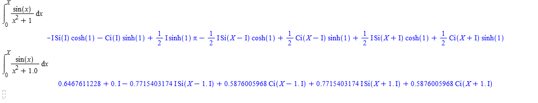

The integral is just too difficult for Mupad. Maple gives the following, where Si is the sine integral and Ci is the cosine integral:
Alan
