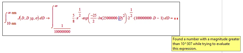

During integration with infinite upper bound, I found that the result makes me doubtful.
Then I checked it by changing the infinite upper bound with a large enough number compare to other numbers in the equation. I got a more sensible result.

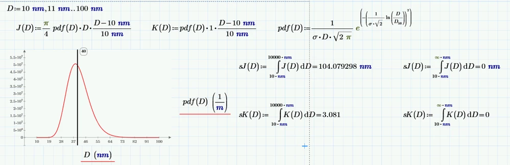

2. did I miss something here in my worksheet?
You did not attach your worksheet!
What happens if you delete (or move down below the calculations) the definiton of the range for D. You only need it for plotting and not for the calculations.
Are you aware that your functions J and K do NOT use the function pdf you defined afterwards but a (probably different?) function you defined earlier?

Sorry I forgot to attached it. I edited my post.
In the previous page, there is the pdf written already.
I copied it there just to have in during screenshot.
I will try to delete D.

The D range is not the problem.

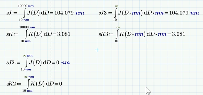

As I had shown with the screenshot from real Mathcad the problem seems to be that the wrong algorithm is automatically chosen (you cannot chose it manually in Prime) if the upper limit is not infinity but infinity times unit nm.
So here is a workaround:

Apart from Werner's correct remarks, the difference is most probably due to an overflow during the numeric integration. This overflow does not occur in the range from 10 to 1000 nm, but somewhere in the vast range between 1000 nm and infinity...
Try to evaluate your integrals (which, by the way are NOT functions of D) symbolically and see what happens.
Producing a 0 answer as a result of this is bad. I'd consider it a bug.

In real Mathcad we can chose the algorithm used for integration resp. we see which algorithm Mathcad choses automatically.
For an infinite limit the appropriate algorithm must be used (not the ordinary Romberg) but as it seems infinity time unit is not seen as an infinite limit and so the wrong algorithm is chosen:
