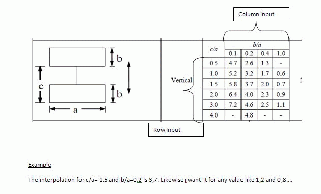

I am doing a hydradynamic calucation in MathCAD, Now i need to get the right coefficient as a output from table of value (row and cloumn). the input for the interpolation is 2 variable each from cloumn 6 row..Please see the attachment for the better understanding

Have a look at the attached worksheet, I think this is what your after.
Where there are blank spaces in your data I have inserted as zero. The image has also been re-attached for clarity.
