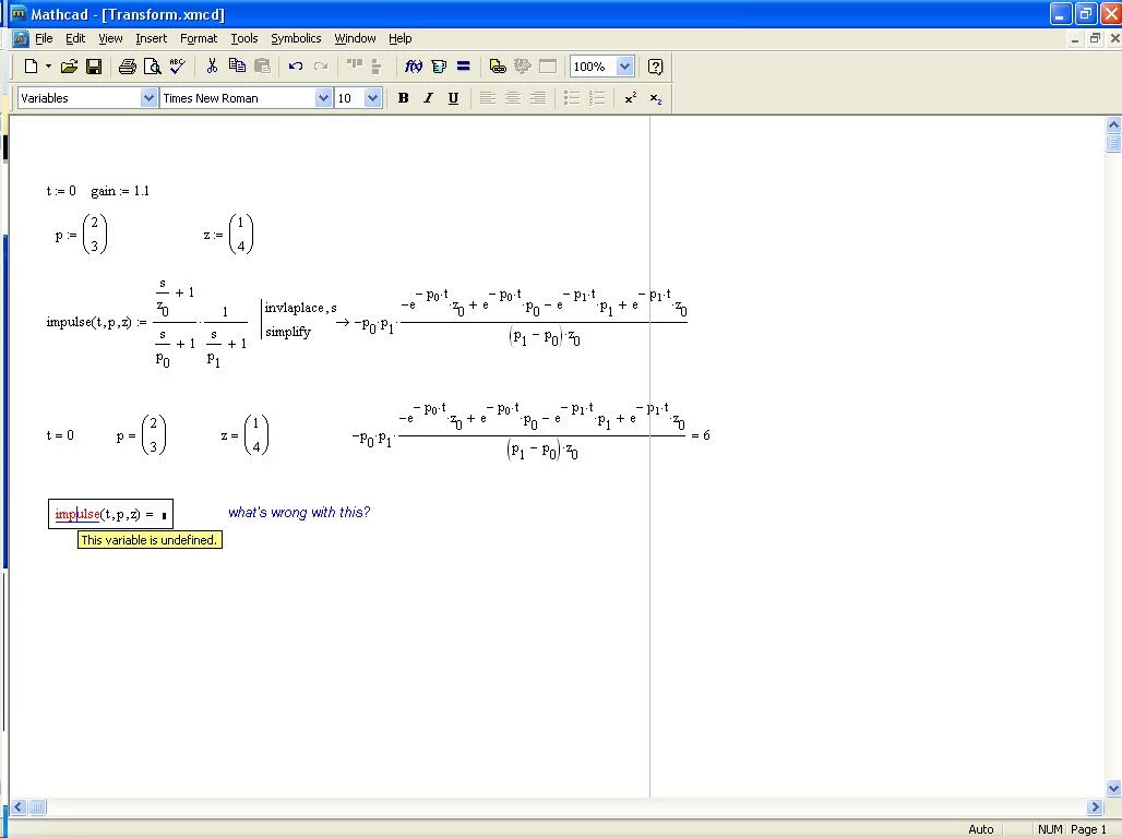

Attempting to perform an inverse Laplace transform
on a simple 2nd order polynomial (2 poles, 1 zero)
The symbolic operation works, but when I attempt to
assign the result to a function, Mathcad 12.1 always
returns "This variable is undefined".
Suggestions anyone?

It appears to be a bug in version 12. It works fine in versions 11, 13 and 14. I can't actually check it in version 12 though because it's such a lemon version of Mathcad last time I changed PC I couldn't be bothered to install it along with all the others. Perhaps someone else that has version 12 installed can check.
Without version 12 I guess that the bug is in the t variable: try to add ",t" in the inverse laplace. Also, write t:=t after t:=0.
If not, must to manual assign the impulse function by copy & paste.
Regards. Alvaro.
