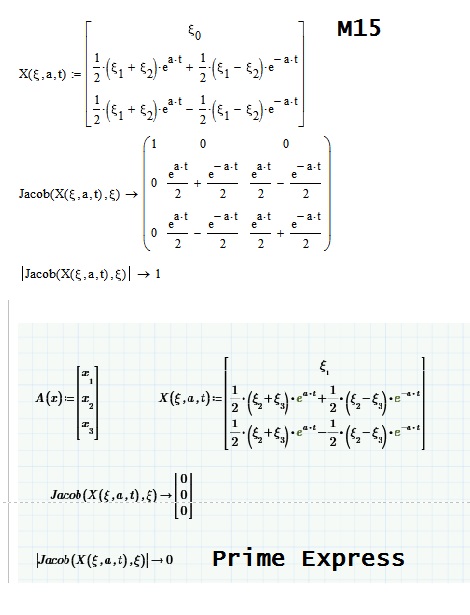

I was about to start a simple problem...and bam! Prime2.0 has its own math AGAIN! I am using Version M010 BTW...
See attached of the Jacobian! I am sure the jacobian matrix is not 3X1.. and the Jocobian determinent is not 0
.Or did they change the syntax for Jacobian ?
Oh my god...why would I trust prime 2.0 for any math?
It has just way too much problem....come one..it is not the first time...
if you have seen my older posts..you know this is not the first problem that I ran into with prime 2.0........................
Best answer by Werner_E
I found it, but I don't know what its called in the english version. The argument xi in the function X when you call jacob is formatted as "variable" whereas the other as "none". So to Prime its not the same variable.
WE
It does look like something's different from M15.
I've only got Prime Express, which doesn't evaluate symbolics. Have you tried explicitly defining xi to be a 3-vector?
Stuart
January 24, 2013
Your worksheet did not work for me either.
I recreated it in MC15, converted it to Prime and now we have the correct results.
I could not spot a difference.
January 24, 2013
I went same route of re-creating in 15.
- looks like another candidate from the mathcad mad-house.
Problem is with the first ξ in the Jacobian.
Regards
Andy
Werner_E25-Diamond IAnswer
January 24, 2013
WE
January 24, 2013
Of course. Keep on forgetting MP's little oddity there.
Nice to know why it fails
Andy
January 24, 2013
PTC's introduction of labeling in prime is too troublesome....It was a good intention but often come out to be useless. I think they must add a reminder to user when ever the exact same 'name' has two different labelling. Math ad prime sometimes automatically choose different label for the same name and it is causing a headache to me.

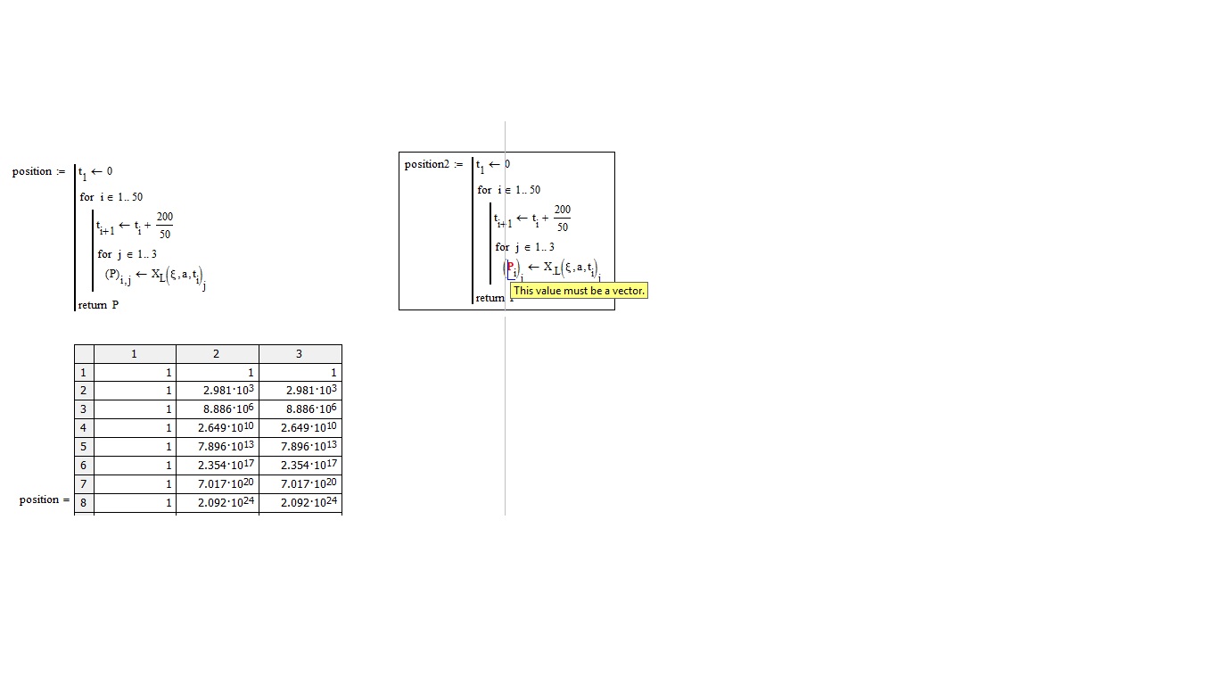

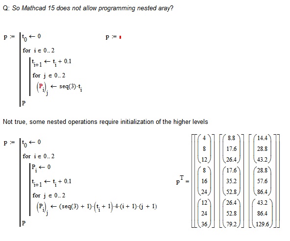

January 27, 2013
So Mathcad 15 does not allow programming nested aray? Thank for any answer in advance.
23-Emerald V
January 27, 2013
henry leung wrote:
