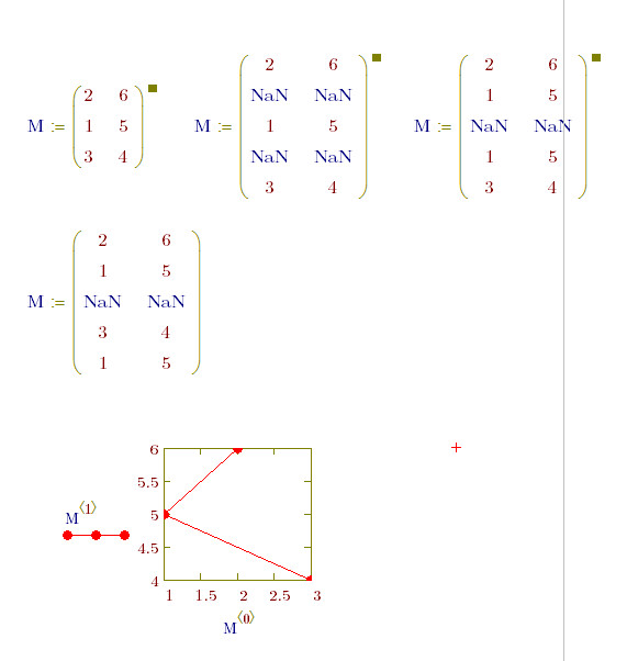

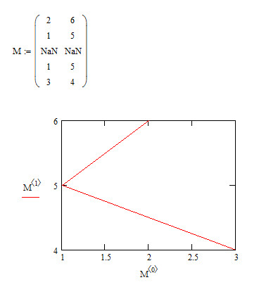

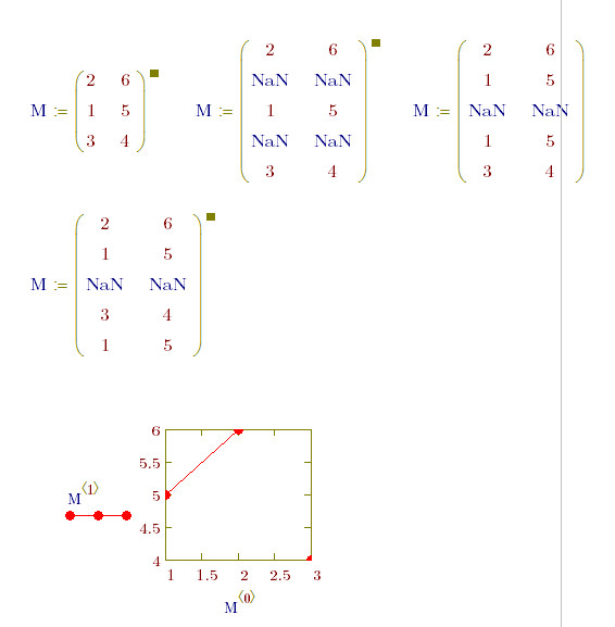

I want plot a matrix with two columns which contains a NaN point by 2D line plot in MC15M030, and like the picture below:
the last two points has not line between them, and when I change the order of the two points,
then the line appears. And I try to plot the first picture in MC11, the result is right.
Is it a bug of MC15M030?

The problem is not primarily the order. I think rather the problem occurs when there is the very same point before and after the NaN's.
Nevertheless I agree that it should work.
A workaround is to set the trace type frome "lines" to "draw", but you loose the points at the vertices if you do.

Oh! It works! Very thank you Werner. I have read a datasets with some NaN points and plotted it in line on MC, and I don't want any break in the line, and then found this matter.
" I think rather the problem occurs when there is the very same point before and after the NaN's.", yes, it really the matter.
I tried a few variations, and I think It's not the befroe and after NAN coordinate values per se, but rather the physical separation of the points on the resulting screen plot. For the same before and after coordinates, the resulting plot shows only one point of the second line segment regardless of plot size. When the before and after coordinates define distinct points, the second line segment will be plotted if the before and after points are "sufficiently" apart. This depend on the plot size and scale, as the plots in the attached file show. Two plots of the same vectors, differning in plot size only, show different results.
