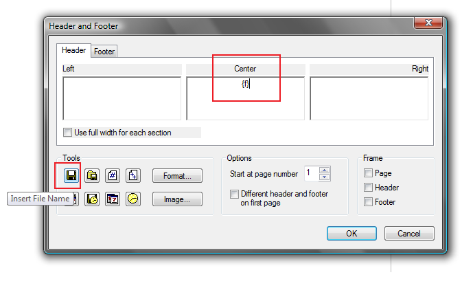

Why do not you use "Header and Footer" tool (in main menu go to "View" -> "Header and Footer ..." -> "Tools: Insert File Name")?
