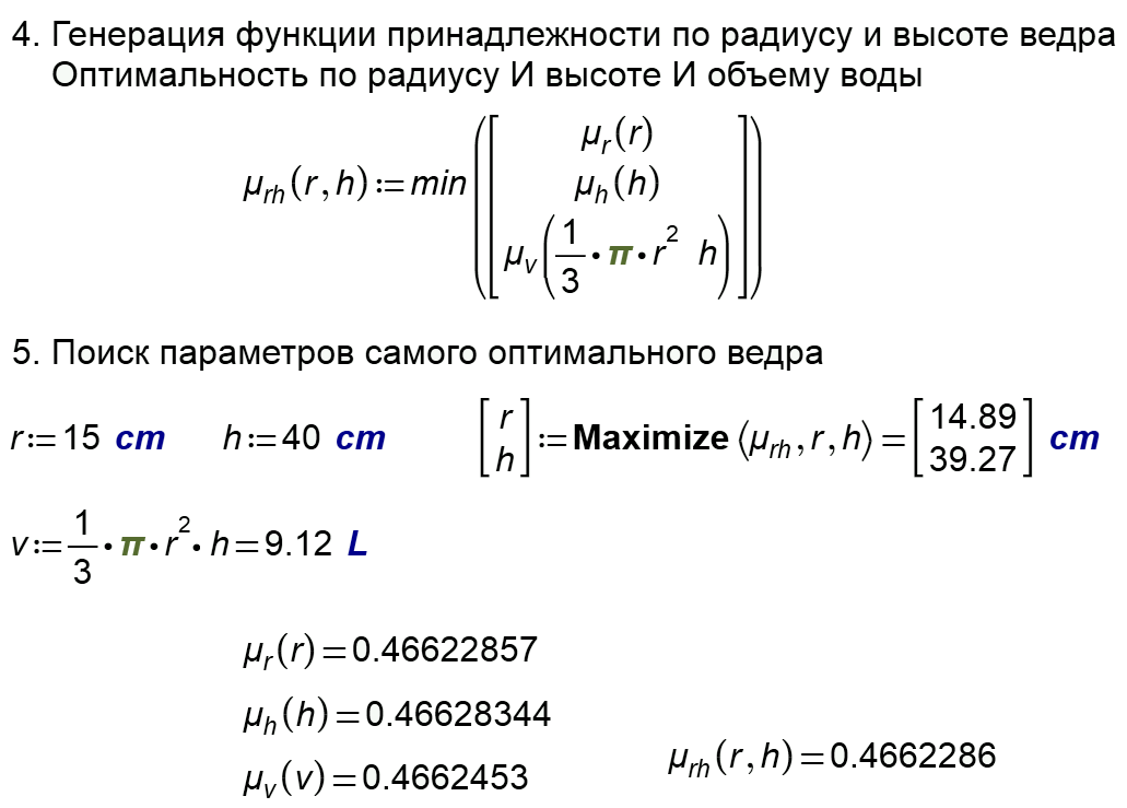

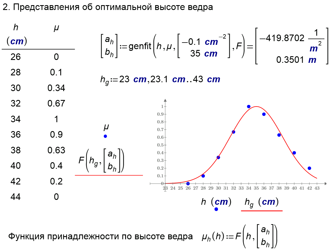

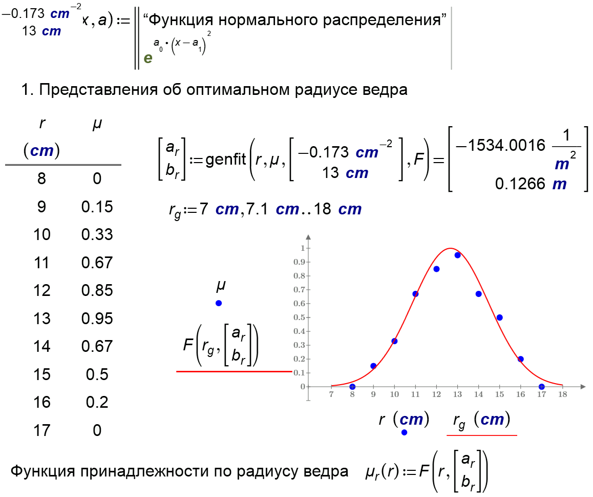

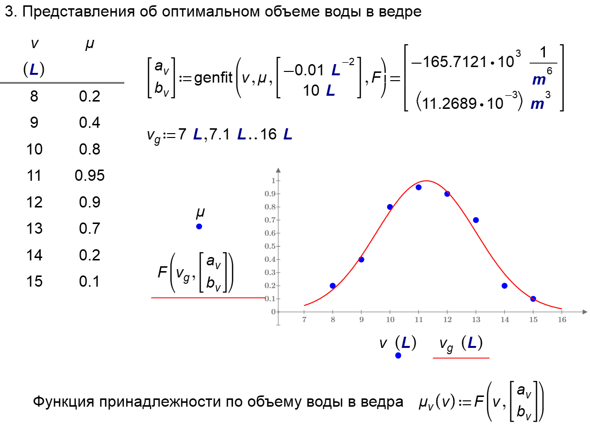

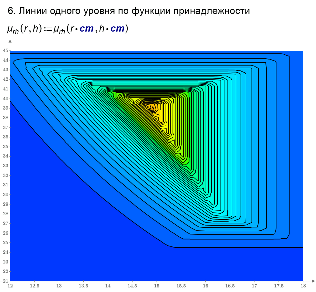

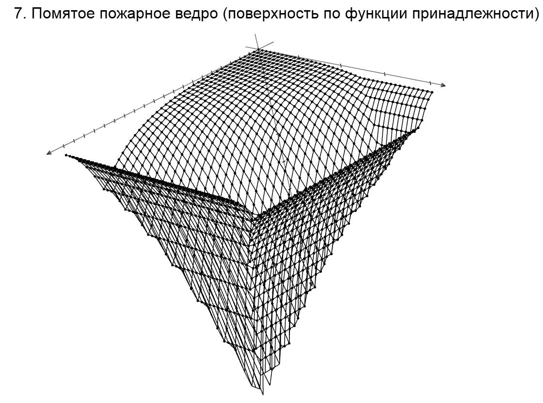

I have a problem with same pictures

I am glad to help you.
See please the Mathcad Prime 3 file in attach
