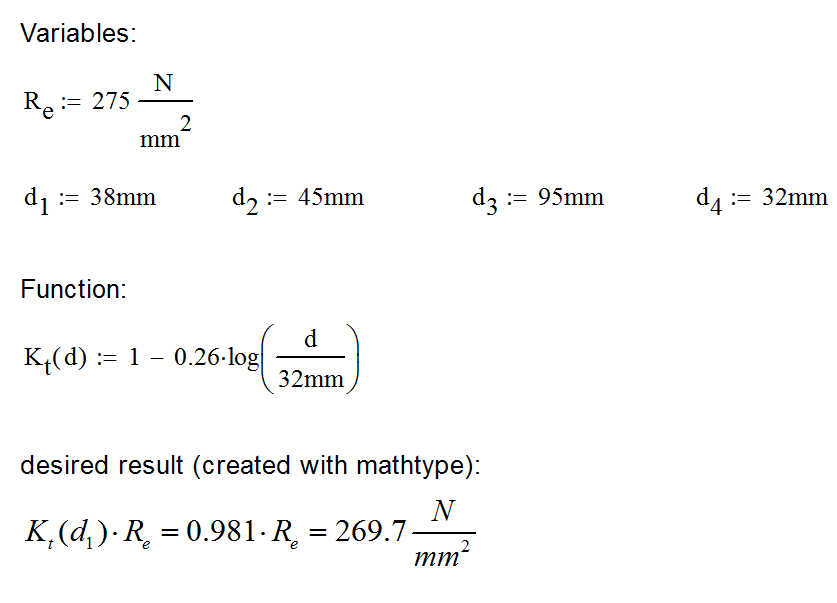

I’ve got Mathcad v15.
With the explicit keywords it’s easy to see your equation with the inserted variables.
But what about functions? I can’t do that.
For example: I want to calculate new yield stregthes according to different diameters with factors, which are received from a function.
Then I just have to replace d1 with d2 and so on.
The explicit operator don’t work:
sincerly,
Robin

The explicit modifier is far away from being perfect, but what you demand can be done. Nevertheless there is a drawback as "float" is used which affects overall calculation precision. See my remarks in the file.
January 25, 2014
Thank you for your explanation about float. I will use it with caution.
