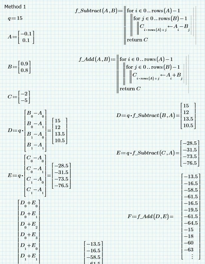

terryhendicott
If you only have the free version of Prime 7 you cannot use the programs.
It can be done without programming
Cheers
Terry

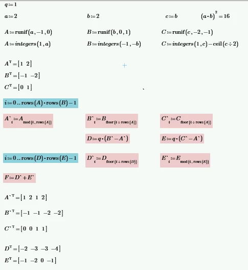

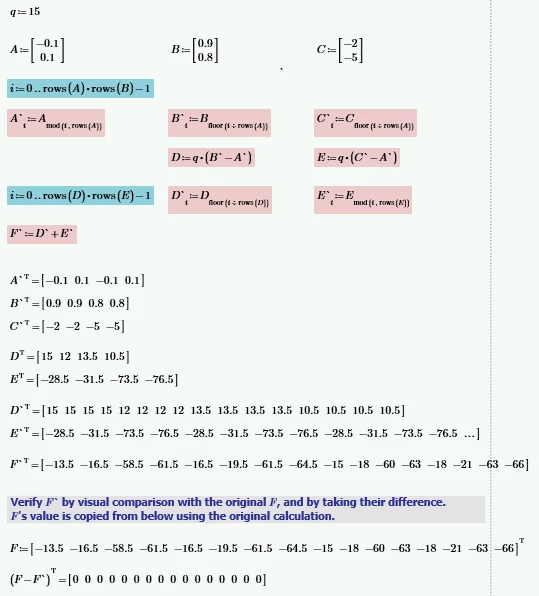

Just another  range variable variant:

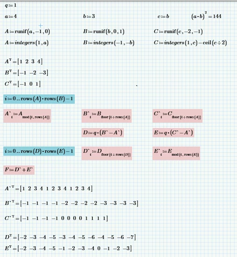

Changing the values of A, B and C to consecutive integers shows the pattern a bit more clearly:
It should work with different length vectors, and even with different A and B&C vector lengths:
I wouldn't recommend working with lengths much greater than about 30, as the memory requirements grow in proportion to length(A)*length(B)^2 ((30*30)^2=810,000).

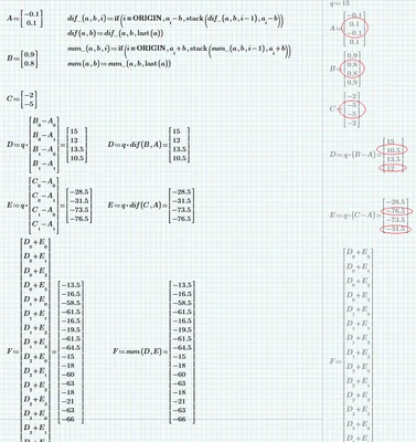

Your method 2 has errors with respect to method 1, did you see that the results are different, because you did not define the new arrays A, B and C in the order that you (apparently) want to use them according method 1?
Anyway, Terry has shown a method that involves, requires, programming. If you are on Prime express that will not work.
Here's a couple of functions that do work, also in express:
And they (should) work with array sizes up to 2000 elements.

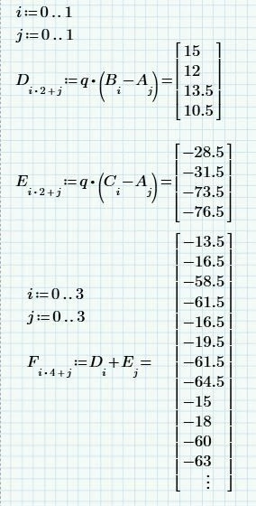

23-Emerald I
Another method that works (even in Express), done in Prime 4.0
