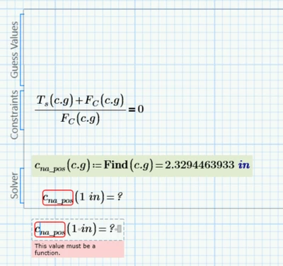

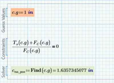

I'm curious if anyone has come up with a solution that is similar to using Find() w/in a Solve Block OUTSIDE of a solve block?
I ask because I'd like to have the Find() ability to iterate/solve but use it as a custom function that I can call for N instances.
There is a lot of value in Solve Block Find() but I have a case where I have a lot of inputs in V for which I would like to Find() solutions. I don't see this working just using a Solve Block.

You have only one equation.
Better to use not the Find function with the Solve block but the root one - with 2 or 4 arguments.

You can turn the solve block into a function and the use this function in your program.
In the example you showed, the only thing you could vary is the guess value.
You may delete the c.g:=1 in region and close the solve block with get_c(c.g):=Find(c.g)
Not get_c(1 in)= gives you the value shown in your picture but you could also try different guess value - maybe get get_c(10 in)= yield another solution.

Thank you Werner! I believe this would have worked as a viable solution but I am not able to define the 'get' function. In any case, @ValeryOchkov 's root method worked so I am going to explore that more.
Mar 19, 2023 7:29 PM UTC
You will have to delete the "=" evaluation after the "find" command.
I thought that the solve block you show would be just a simplified example of what you are really trying to achieve because you wrote something about various input variables you would like to vary.

Excellent, thank you @ValeryOchkov !! That worked. I am going to test it out some more.
