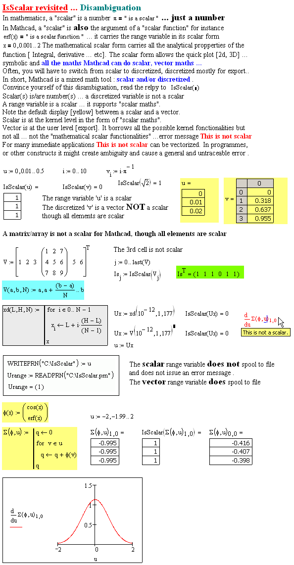

Jean,
Scalars - You have enlightened me with your explanation.
I have only once found a valid application for the IsScalar function, see attached image. This was a function Stuart produced called 'Setcount'. Might be worth supplying a few examples of using the function so other collabs can follow.
Mike

Jean, Scalars - You have enlightened me with your explanation
________________________
Here attached, the supplementary example of the range to vector converter from Stuart. "IsScalar" is usually paired with "matchNaN" and "markNaN". .. "FilterNaN". You may want to detect/decide about the outliers in a data set, mark them "markNan", then apply If IsScalar (matchNaN) and get rid of the outliers . This application is detailed in the DAEP [Data Analysis Extension Pack]. If you don't have that Pack, I could eventually reproduce it .

Here is the function.

A range variable is not a scalar. A scalar is a single number. A range variable contains three pieces of information: start, increment, and end. If you use a range variable as a function argument, it does not pass the range variable to the function. It evaluates the function for each value defined by the range variable, so what is passed to the function is a sequence of scalars (so still not a scalar, but a sequence of scalars!). This is true for any function, including IsScalar. So what you get is a series of 1s as the result. If you pass a range value to IsScalar what you get as a result is 0.

Richard,
We are saying the same thing except that you are wrong !
>A range variable is not a scalar < [Richard]
In Mathcad, the range variable, i.e: the argument is a scalar [Jean]
That's all what it accounts for: disambiguation between the book definition and the Mathcad logical test vis the applicable numerical algorithms. I'm glad we have these two, side by side. So many, too many This is not a scalar ... There must be an array in there have been corrected in the former Mathcad collab. It might be a good idea to collect more of This is not a scalar.
Thanks for reading and collaboration.
Jean
What book defintion? There is no book definition of a range variable. Sorry, but I have no idea what you are trying to say.
What have arrays got to do with it? A range variable is not an array either.
