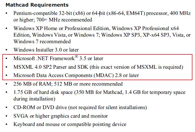

On the PC following programs (from Microsoft) should be installed also (data from "Mathcad Requirements"):
• Microsoft.NET Framework® 3.5 or later.
• MSXML 4.0 SP2 Parser and SDK (this exact version of MSXML is required).
• Microsoft Data Access Components (MDAC) 2.8 or later.
November 23, 2012
Thanks for the hint.
Currently I have the following versions installed:
  • Microsoft .NET Framework 4
  • MDAC 2.8 SDK
However I would expect a more specific error message if there is a package missing.
