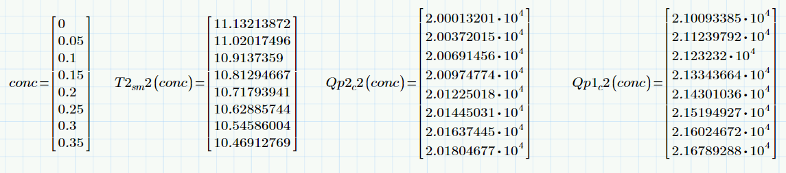

Hi to all
Can any body review my uploaded file and see what is the error because this file hanging when i ask about last result
November 26, 2011
ahmad noureldin wrote:
Hi to all

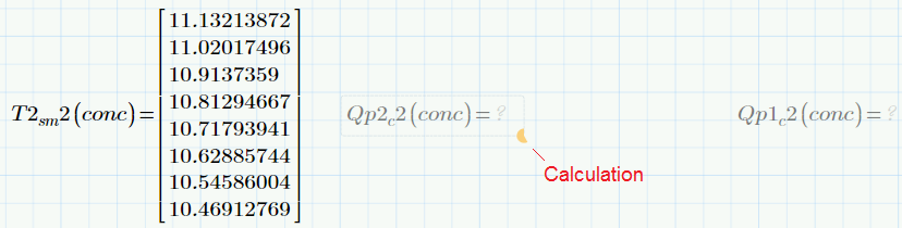

Not hanging but will be calculate for a long time - see the picture.
I know this problem. I calculate one point with a big sheet than I would like to plot a graph and change the sheet - I insert user functions - it was a:=... it is a(t):=... etc for example. All is OK for one point but calculate for a impossible time for a set of points. And I must to plot a grapf manual

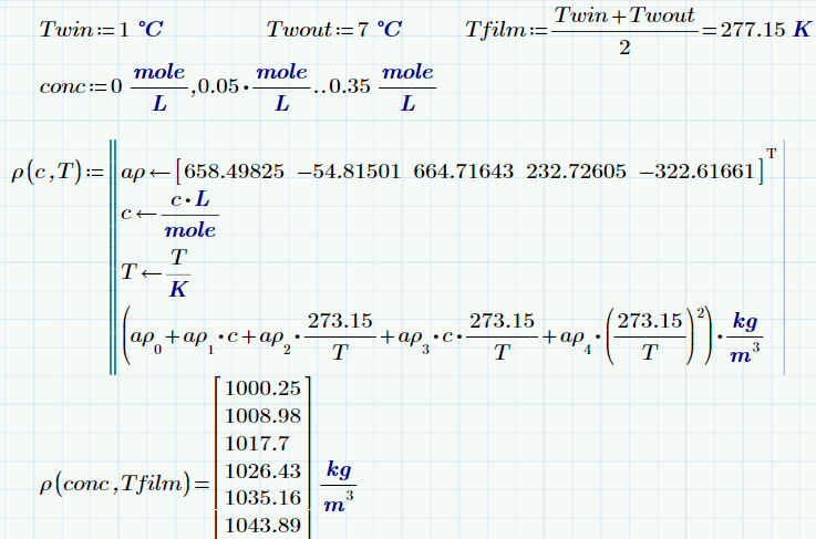

One question - why do you not use units of temperature, concentration etc in your problem?
November 26, 2011

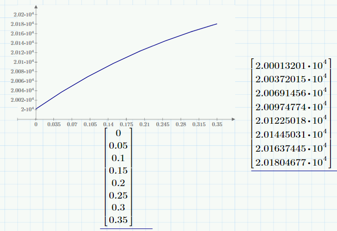

I have the answer in 10 min (when a have prepared the answer on your question).
Please use this vectors not functions for a graph plotting. The graph plotting with function needs a long long long time!
November 26, 2011
With units:
