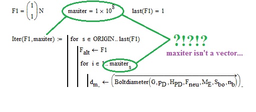

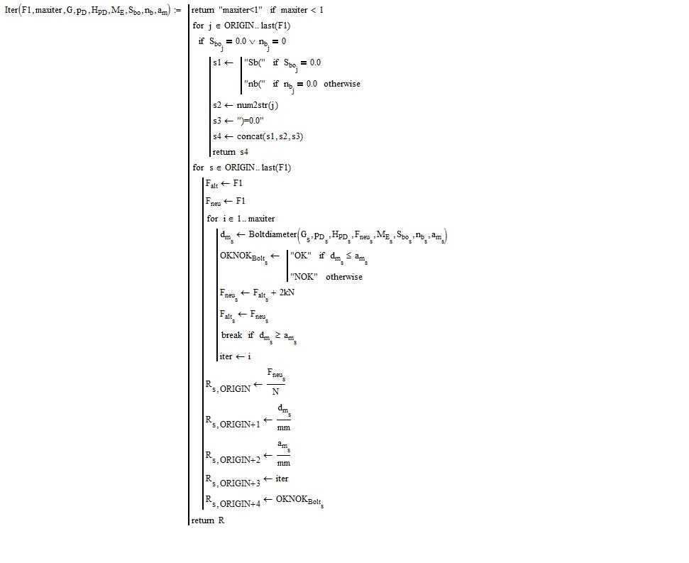

Hey guys,
i modified my iterative calculation and it is better to work with that functions and variables.
Having now the problem, that the calculation for the second row is not correct.
It should be an independend calculation for every loadcase with a different maxiter.
And the second example is not working.
Can anyone see the failure?
THx guys

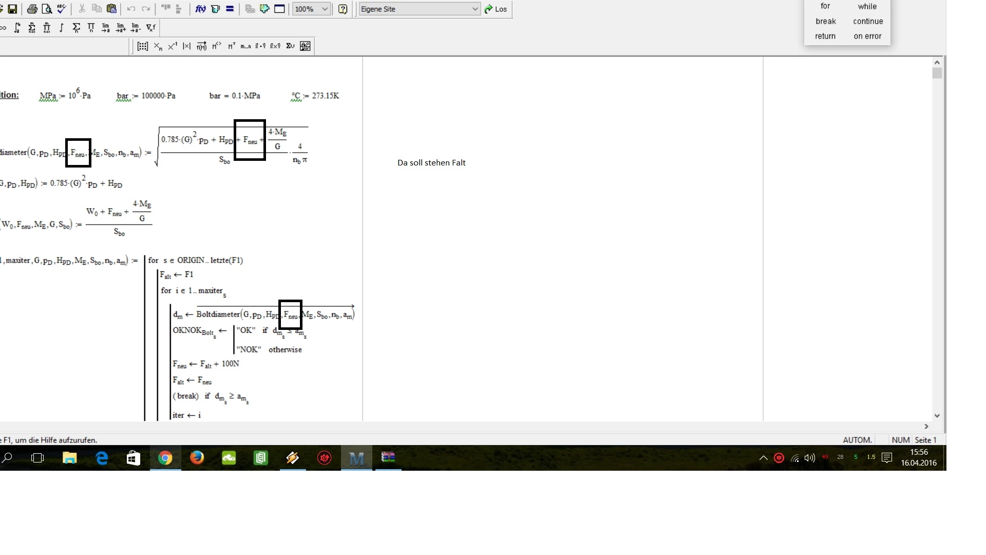

April 16, 2016
I think i solved a part of my failure but still dont know why my second example doesnt work.
Hopefully anyone can help me finding the failure.
Is this now correct iteration?
Best thx to all!

Hello Mr. Stefan, maxiter is a scalar or a vector?
April 16, 2016
He is never using the scalar "maxiter" (the worksheet variable) as argument of his function when calling it.
He is always using
which IS a vector
Its a bit strange, and confusing indeed. The global worksheet variable "maxiter" is a scalar, but the formal function argument "maxiter" always is a vector. Again same name for different things. So in this respect all is OK (given we are looking for the error in his sheet), apart from the fact, that its a very bad habit doing things like that.
Werner

Ok so i out in the iter() all variables i need in the following loop code.
But what i still dont get is, im working in that code with scalars?
But how do i handle the Vectors later on because i have more than 10 loadcases?
OK im gonna try it thx

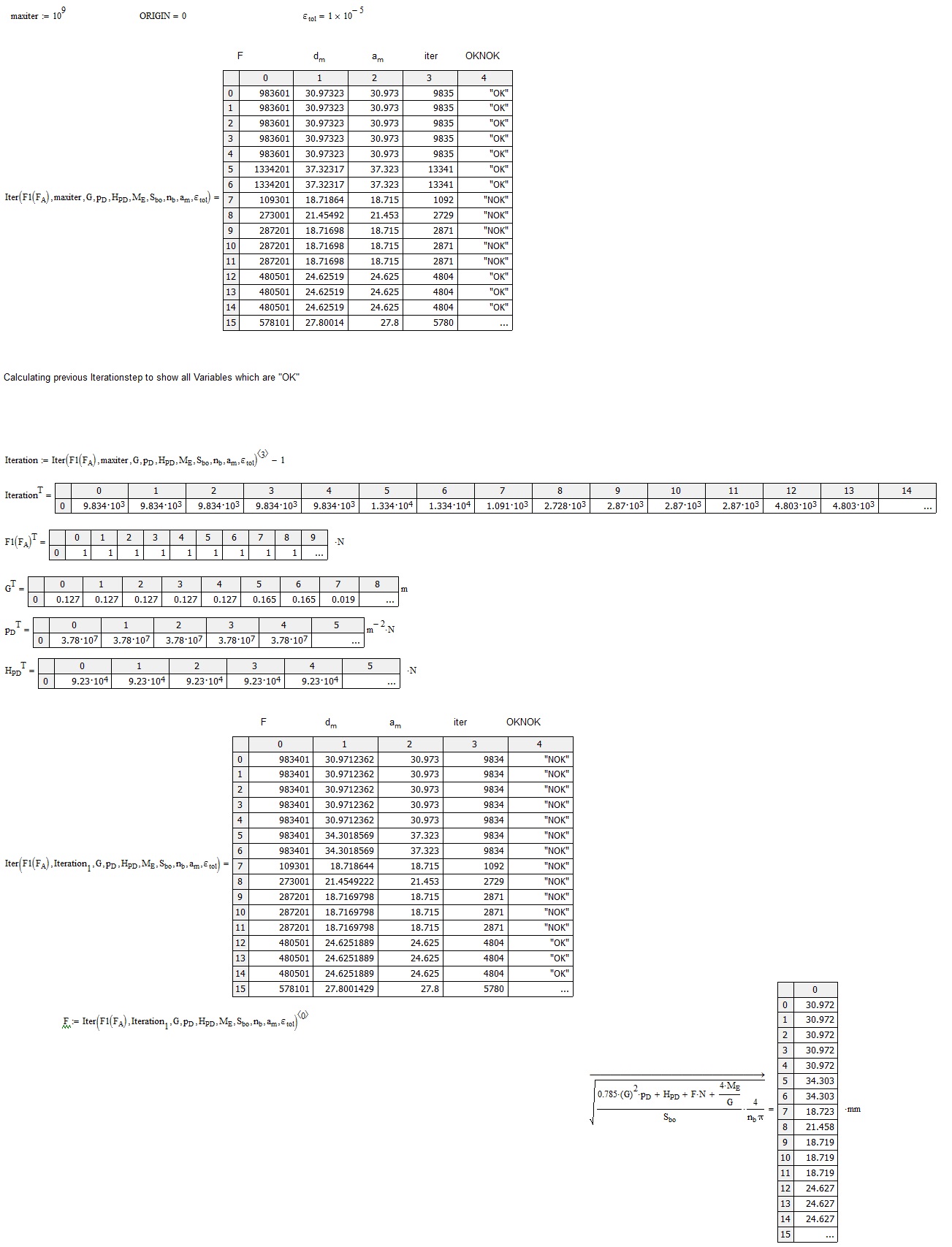

Yes i tryed but i need more than only getting the last force.
How do i get for example the diameter

yes im on the way to get a correct iteration
OK i  made the Iteration on your tipps and i hope it is better now. ANd it is what you meant:
But having problems with row 7 of the Result.
Hopefully i did understand what you tryed to explain to me
I think there is a general failure in my code because when i am changing am in the vector of row 7 it has an influence on the following result of row 8
Strange...
I think i need to change the code to get the program work properly

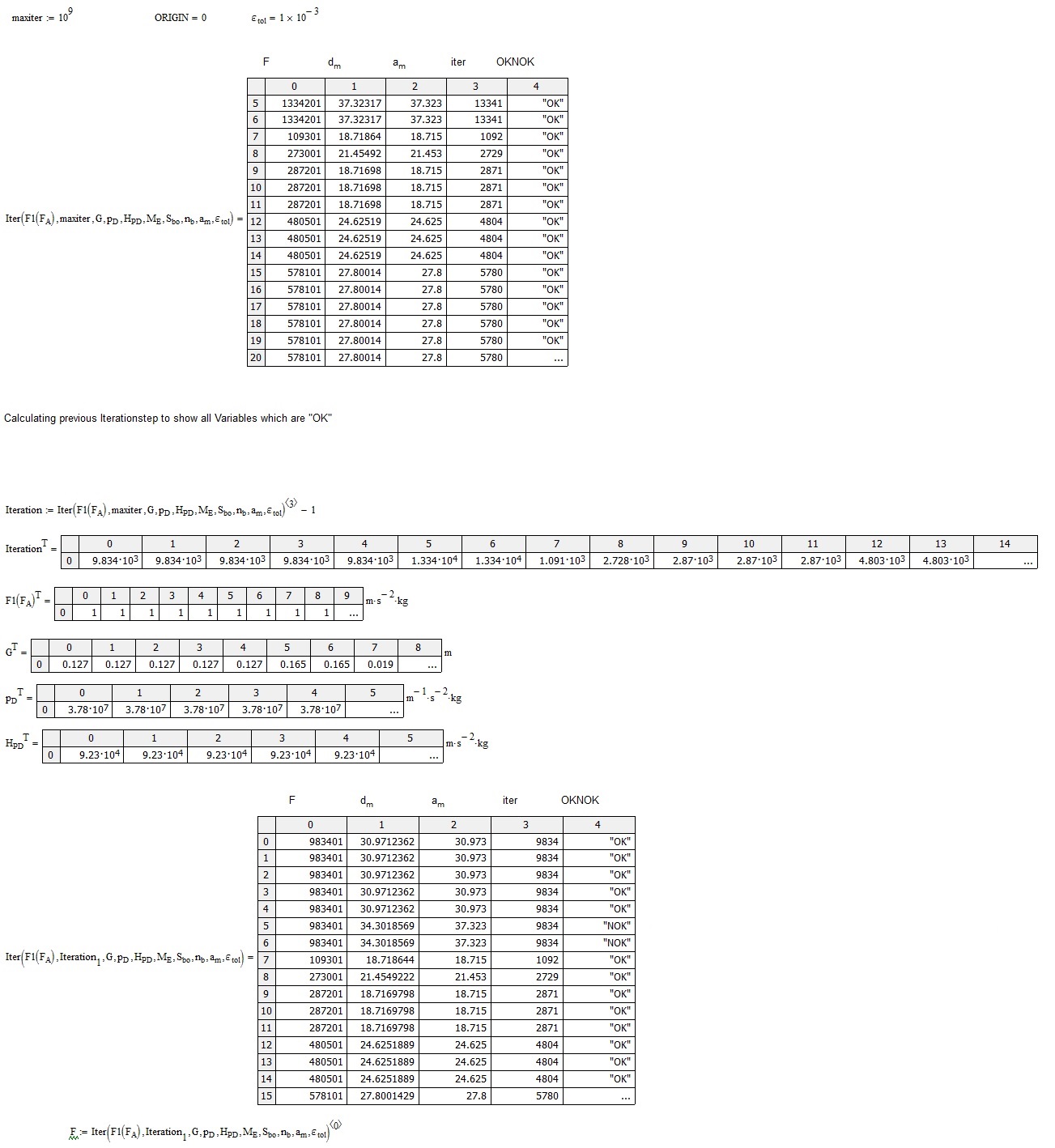

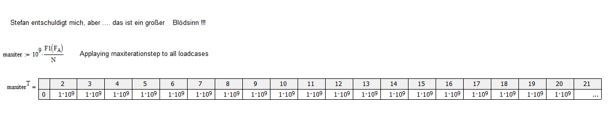

Hello Stefan do you like  this solution?
April 16, 2016
@ F.M.
Looks to me like the force values in your last table are wrong!
Could it be you haven't created a solution on your own but just used Stefans faulty calculation routines?
Can't tell without the sheet.
E.g. in row number 6 F should be around 1334000 N yielding a bolt diameter of approx 37.3223 mm (slightly smaller than the limit 37.323 mm).
Your table says F=983401 N and you get a bolt diameter of 34,302 mm which is much /too) smaller than the 37,323 mm.
WE
April 16, 2016
You are right Werner. The reason is that I used a very great tolerance. If I use a much smaller tolerance, the result is more satisfactory.

Although I don't know what is a.m, I would introduce a relative tolerance to be compared with that obtained between the calculated diameter of the bolt and a.m, and stop the iterations when the latter is less than or equal to the given tolerance. As you can see in the program, the operations are all between scalar variables (elements of vectors) with indices.

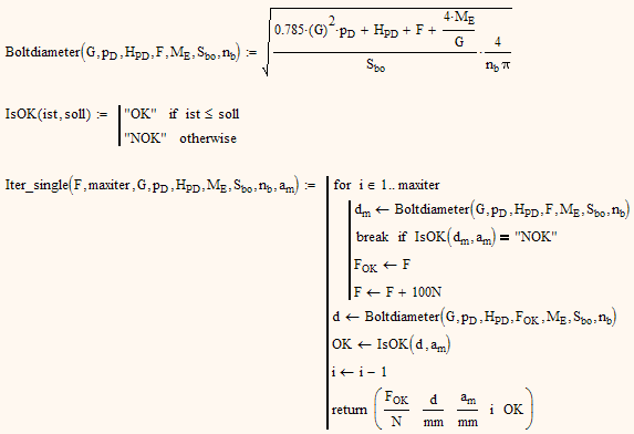

> Später muss ich die Rechnung noch um andere sachen erweitern, sodas sich dann viele andere Abbruchkriterien für die Kraft habe. (Schraubenverbindung, Bauteilfestigkeit etc.
Ja. daher ist es sinnvoll, die dazu nötigen Berechnungen (wie hier eben den Bolzendurchmesser) in Funktionen auszulagern, um das eigentliche Iterationsprogramm möglichst übersichtlich zu halten.
Ich denke ja noch immer, dass die Aufgabe(n) trotz unterschiedlichster Abbruchkriterien doch mit einem Lösungsblock realisierbar sein könnte. Für den Bolzendurchmesser allein hab ich das ja in dem anderen Thread gezeigt, wie es gehen könnte.
> Die sachen lassen sich nciht direkt lösen und müssen itertaiv bestimmt werden.
Naja, zumindest für Kraft/Bolzendm. stimmt das nicht. Auch da hatte ich ja schon eine direkte Formel zur Berechnung angegeben. Allerdings wird es bei zusätzlichen anderen Kriterien wohl so sein, dass man tatsächlich keine direkte Berechnungsformel angeben kann.
Aber vielleicht können wir ja zumindest die Angelegenheit hier doch noch zufriedenstellend abschließen.
Im Anhang meine Lösungsvariante, welche hoffentlich auch demonstriert, was ich mit meinen bisherigen Anmerkungen meinte.
Zunächst ist die Dmberechnung und auch die OK/NOK "Berechnung" ausgelagert, da ich sie in meiner Routine mehr als einmal benutze. Danach folgt die von mir immer wieder "eingeforderte" Berechnungsroutine, die nur und ausschließlich auf skalaren Größen operiert. Diese wird vorzugsweise oberhalb der Definition der Eingabevariablen geschrieben, damit man nicht irrtümlich etwas benutzt, das nicht als Parameter übergeben wird. Diese Routine, die also nur einen Satz Daten berücksichtigt, habe ich "Iter_single" genannt:
Du siehst, dass ich hier nicht mit F.alt und F.neu herumeiere, ein F reicht völlig. Nur, um nach den Abbruch noch den vorherigen Wert zur Verfügung zu haben, speichere ich jeweils den letzten Wert von F, bei dem der Vergleich noch OK war, in einer Variablen F.OK. Und nur diese und der zu diesem Wert gehörige Durchmesser und OK-Wert werden dann zurückgegeben. Deshalb müssen diese nach der for-Schleife neuerlich berechnet werden. Man könnte alternativ so wie das F.OK auch ein d.OK und vl ein OK.OK mitführen und sich damit diese Neuberechnung ersparen
Probleme kann es hier geben, wenn bereits der Initialwert zu einem zu großen Durchmesser führt (als F,OK wird dann 0 angenommen). Das sollte man der Ordnung halber vl noch abfangen. Ich wähle aber bei den folgenden Aufrufen ohnehin immer 0 N als Initial-Wert, da passiert das offenbar nicht.
Jetzt gibt es mehrere Möglichkeiten, diese Routine zu verwenden. Entweder tatsächlich nur mit einem Datensatz
oder aber mit Vektoren als aktuelle Parameter, dann aber muss der Aufruf vektorisiert werden
Hier sieht man jetzt schon die Problematik - das Ergebnis ist eine verschachtelte Matrix. Wir erhalten einen Vektor dessen Einträge jeweils 1 x 5 Matrizen sind. Das ist für weitere Berechnungen und Ausgaben recht unhandlich, weswegen ich noch eine eigene Routine "Iter" nachgeschaltet habe. Diese ruft "Iter_single" in jedem Fall vektorisiert auf, prüft danach, ob das Ergbenis eine verschachtelte Matrix ist und schreibt diese dann gegebenenfalls in eine normale Matrix um.
Ich hab der Rückgabematrix auch noch einen Zeile mit Spaltenköpfen spendiert.
Die Routine "Iter" kann jetzt also sowohl mit skalaren Werten, als auch mit (gleich großen) Vektoren aufgerufen werden. Wenn ein Eingabevektor nur aus lauter gleichen Einträgen bestehen würde, kannst du stattdessen auch einfach nur den skalaren Wert hinschreiben, so wie ich das mit F.init und maxiter gemacht habe:
Mit deinen Werten ergibt sich dann folgende Tabelle:
Das wärs eigentlich auch schon. Schmerzlos und im Grunde recht kurze Routinen.
Ich hab auch noch als Alternative eine weiter Funktion "Iter_neu" geschrieben. Diese orientiert sich an deinem ursprünglichen Ansatz indem sie die Vektoreingabewerte mit einer Schleife (ich hab den Schleiferzähler s als Name übernommen) einzeln abklappert, damit die Funktion Iter_single aufruft und die Ergebnisse gleich in einer Matrix (auch mit Spaltenköpfen) aufsammelt. "Iter_neu" hat eigentlich keine Vorteile gegenüber "Iter". Im Gegenteil, denn "Iter_neu" kann nicht mit lauter skalaren Werten aufgerufen werden, sondern es müssen hier F.init und maxiter Skalare sein und die anderen Parameter müssen (gleichgroße) Vektoren sein. Also ist "Iter_neu" eher eingeschränkt und weniger flexibel.
Hoffe, dass wir damit diesen Thread erledigen können.
LG
Werner

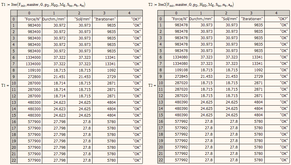

Eine Ergänzung noch dazu, nämlich eine weitere Möglichkeit, nach dem Abbruch der for-Schleife zu einem gültigen F-Wert zu kommen und diesen auch noch genauer als auf 100N genau zu bekommen.
Nachdem die for-Schleife abgebrochen wurde, geht es in eine neue Schleife, die solange F um 1N verringert, bis der Vergleich von d und a ein "OK" ergibt. Auf diese Weise hast du nun die Kraft F auf 1 N genau. Das ist jetzt sozusagen die verfeinerte Version meines allerersten Vorschlags zur Rückgabe des letzten gültigen F-Werts, den ich bereits in dem anderen Thread gemacht hatte. Dort hatte ich gemeint, dass du mit F doch nur einen Schritt, also 100 N, zurückgehen musst.
Ich habe mir hier nicht die Mühe gemacht, den Iterationszähler "i" in dieser zweiten Schleife weiter hinauf (oder runter?) zu zählen, weil ich ohnedies nicht verstehe, warum du diesen Zähler überhaupt ausgibst. Wenn du mit 0N als Startwert beginnst, immer um 100N erhöhst und es stellt sich dann F=983400 N ein, dann ist doch ohnedies klar, dass F eben 9834-Mal erhöht wurde und nach deiner Zählweise sind das dann 9835 Iterationsschritte.
Hier die neue "Iter_single2":
Die neue "Iter2" ist gegenüber "Iter" unverändert, nur ruft sie eben "Iter_single2" auf.
Hier zum Vergleich die Ergebnisse von "Iter" und die genaueren von "Iter2" (noch genauer machts ein Lösungsblock 😉
Der Unterschied zwischen a.m und d.m ist nun schon so klein, dass er kleiner als ein Mikrometer ist und daher in der Tabelle nicht mehr zu erkennen ist.
WE

Du musst doch zwischen einer Variablen W, die du mit W:=a+b definierst und einer Funktion W(a,b):=a+b unterscheiden? Ich verstehe deine Frage nicht ganz. Eine Variable wird doch in einem Lösungsblock nur dann definiert, um einen Schätzwert anzugeben und das sollte man (muss man aber nicht) oberhalb von "Give" machen.
Und wie jede andere Variable auch behält sie ihren Wert solange, bis eine neuer zugewiesen wird.
Den Rest deiner Lösungsblockfrage verstehe ich dann leider überhaupt nicht. Solltest du vl besser nochmals und mit ein paar erklärenden einfachen Screenshots neu stellen.
Werner

Aeh wo ist die s Schleife?
Wie geht den das und trotzdem behandelt er jede Zeile der ganzen Vektoren extra ? Bin etwas verwirrt?! Oder Magie 😃

We rely hero on that the very first initial value of F is an OK-value.
Otherwise the returned F will be zero.
Wenn das nicht so wäre hätte ich ein sehr großes Problem hahahahah
April 17, 2016
Ja, das war mir schon klar, dass es kaum sein kann, dass der Bolzendurchmesser auch bei einer Kraft von 0 Newton schon zu groß sein müsste.
Trotzdem sollte jede Funktion, die man schreibt, alle theoretisch möglichen Fälle abdecken, auch wenn der Problemfall so wie in deiner Anwendung praktisch nie eintreten kann.
