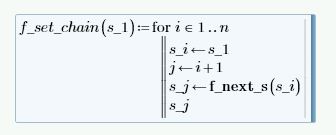

I’m quite new to Mathcad and Mathcad Prime. I already looked for a solution in this forum and in the help files, but did not find anything suitable. Here’s my problem:

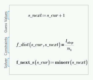

I defined a function f_next_s: Input s_n (current) -> Output s_n+1 (next).
Now I want to repeat this procedure n times, starting with s_1(given):
Step INPUT (s_cur) OUTPUT (s_pre)
1 s_1 s_2
2 s_2 s_3
3 s_3 …
n s_n s_n+1
AND
I want to store the values of s_1, s_2, … s_n+1 so that I can go on calculating with them.
Here is what I tried, but it doesn't work (it only gives out the first result, which is s_2):
Here ( http://communities.ptc.com/message/157701#157701 ) it says I should write the values in an array. But I can’t figure out how this works…
Can you please help me?
Best regards
Sebastian

July 7, 2011
I'm confused. The program you showed in your first post is not the same in your worksheet
Can you clearly indicate which function has the problem and list the expected results, sorry I am mad busy today and haven't got much spare time
Mike
23-Emerald I
July 7, 2011
I don't have Prime in front of me right now, but I think the answer to your problem is that you're not making an array in your program. I've enclosed a short file in version 14 that illustrates.
I hope this helps.

July 7, 2011
The last line should just be "s". If you return s[j then it will return only the element of s that corresponds to the current value of j (which is of course the last value).
