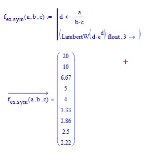

I am trying to calculate the current I dependent of V of a photovoltaik cell in . To solve this equation I am using the LambertW function. Unfortunately, I ran into two problems that I have not figured out yet:

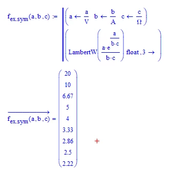

1. I wanted to define the argument LambertW-function W(z) in symbolic form, i.e. I wanted to type out equation I want to use for z inside the parentheses of the LamberW-function. I made sure that all the units in the function cancel each other out. Nonetheless I receive an error, that "This value has unit voltage, but needs to have unit unitless". If I just solve the argument z of the function the value is unitless. The expression W(z) can be solved though however if I provide unitless variables. I achieved this by dividing each variable by its respective unit, therefore making the input unitless. This bothers me a little though since I haven't found the reason for this problem or how to solve it.

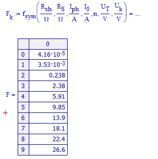

2. I wanted to plot the function W in depence of V. To do this I defined a vector U[k with kmax steps for my voltage. The solver can't finde a solution if kmax is greater than 8. Even in my simple example I only get "NaN" as a result if kmax is 9.  I didn't change the maximim and minimum voltages, just the step width. However if I calculate the values of the argument z of the LambertW-function before I calculate W(z) I can use a kmax greater than 8.
Does anybody have an idea why my original solution doesn't work and why I can't calculate more than 9 values when using kmax=8 ? Thank you very much in advance!

The symbolic does not know anything about units.
How about this approach?
A better approach:
According your second problem:
You must be aware, that the mix of symbolic and numeric evaluation can cause more problems you may think.
Your function f.sym looks like it returns a true numeric result, buts thats not true. Its still kind of a symbolic value.

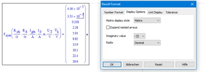

The reason for your calculation failing when trying to calculate a vector with more than 9 elements is because mathcads numeric switches by default from "matrix" display to a scrollable "table" display if the vector has more than 9 elements.
You can get the result if you change the output from "table" to "matrix" via the "Result Format" menu (double click on the result):

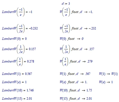

Attached is a Mathcad 11 file with an implementation of the LambertW 'function' that corresponds well with the symbolic equivalent:

That may be because it uses, essentially symbolically evaluates, the symbolic Lambert 'function': W(). This function may not exist in MuPad...
On that one line where it is used, replace
W(1) float, 12 ->
by the numeric value, which is: 0.567143290409784
Try if it runs after you change that.
