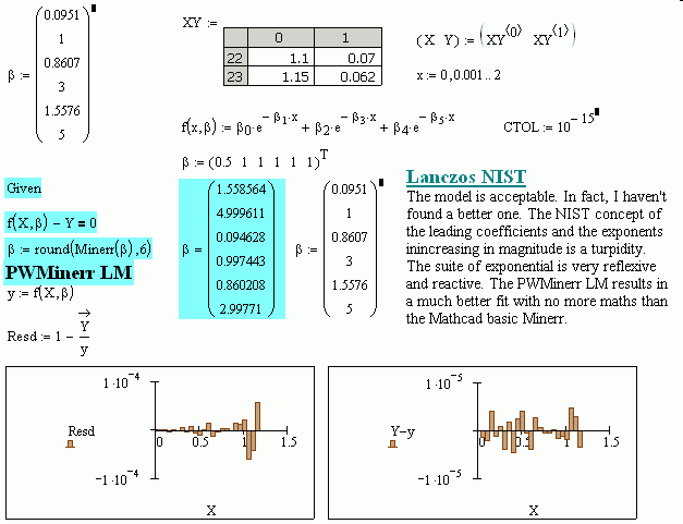

There is more to consider in curve fitting than thinking you are missing something. Clean data do not exist unless from a pure mathematical function. Collected data are subject to the digitization noise. A good figure is ± 0.001. Lanczos reveals ± 0.000005 ... a damn good lab equipment. What's ridiculous from NIST publication is the all lot of trailing zeros [non sense]. That their "statistical methods" arrive at the coefficients and exponents in increasing magnitude is erroneous. The exponential suite is very reflexive [not reflective] and reactive. The free raw PWMinerr arrives at a more realistic fit much faster and more economical in calculations. The PWMinerr was discovered after the DAEP was designed. About your "Acc" question, just forget it, rather go ahead with more advanced fitting techniques.

Totally correct Raj. For years in this collab, nothing else than PWMinerr has been used and genfit completely abandoned. Most of the times Levenberg-Marquardt [LM] is the best option and generally the sole option. On very difficult models [not necessarily huge models], it will be Conjugate Gradient [CG]. Often we have to iterate manually... often again initialising the fit is very difficult and when too difficult it must be found manually. Mathcad has never failed fitting data. As a detail, I have done a lot of comparative fits between Mathcad PWMinerr and ORIGINLAB advanced statistical fitting that often fails, but not Mathcad.
