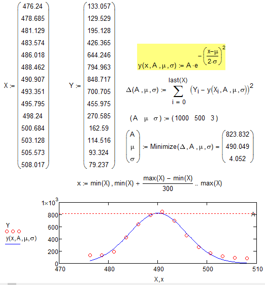

Best answer by VladimirN
Some adjustment for the "f" function:
August 2, 2013
May be this is a help for you:
