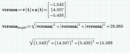

hey folks i am trying to get prime. to give me the lenght of a vector but i cant get it to work
any one who has any idea why i cant get this equation to to work in prime 2,0
in the third line i wrote how it should end up

but this dosent work in prime
any ideas ???

Seems you forgot the indices in the prime version of your attempt.
Why don't you just use the absolute value
vcrossa_length:=|vcrossa|
What you did in Prime was to take the square root of (three times the square of the length of your vector).
In other words you calculated the length of the vector times the square root of 3.

thank you. most helpful....
