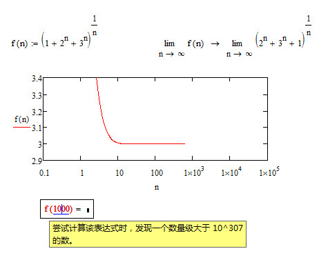

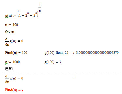

I use mathcad 15 M020 to quest the limitation of:
(1+2^n+3^n)^(1/n), n-->infinity
and the answer should be 3, but in mathcad it seem can not calculate it.
and I try it on the Prime M010, false too.
Why? and How should I solve this problem?
My pc system is Win7 ultimate.

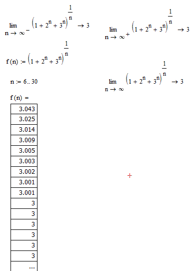

Works fine in MC 15 050...don't know about 010. I used the left hand limit from the toolbar, but all limit directions worked.

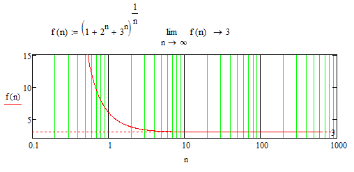

My studens always check limits with plots. If it is possible!
March 10, 2013
No, I use your method to plot the f(n), the "n" can not reach 1000, and when I calculate f(1000), it return an error----Trying to caiculate the function, found a number with an order of magnitude greater than 10 ^ 307.
Sorry, my mathCAD' error message is Chinese.
And when I calculate the lim(f(n)) n-->100000, my computer crashed.
It seemly that MC15M020's limit symbolic system isn't work on the right way.
March 10, 2013

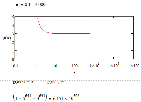

Another interesting scene, from the plot I can assume that when f`(n)=0, the f(n) is on the limit point.
and...
The error message is "The variable is undefined".
and then I try to find the maximum of n:
It seems that the limitation symbolic calculation has used a numerical calculation method.

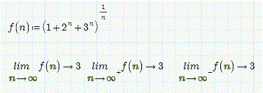

I'm have Windows 7 home edtion 4GB ram ,Mathcad 15.0 (15.0.0.436 [006041742]) version and Mathcad Prime 2 F000 (2012.02.17.RC06/2.0.0.176). Work fine to me.

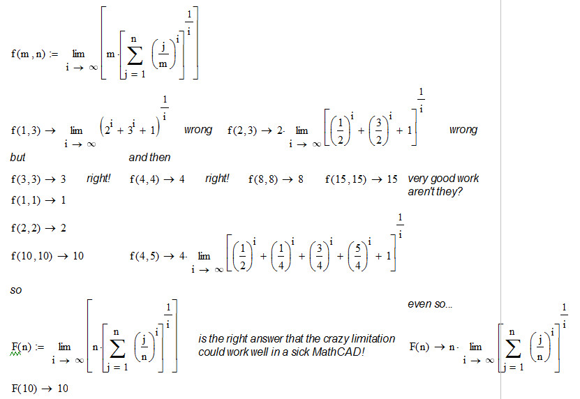

That's a confusing phenomenom. Does it work for you with more than three summands? I think if you add more and more summands Mathcad will fail eventually. I don't think its able to simplify s(k) to k, right?
As far we have three for which it works (Harvey, Valery, Jan) and two for which it doesn't the original poster and me).
How far (speaking of k) can you go with the value of k until MC fails?
March 10, 2013
For k = 100 the result is, but the larger k this requires greater computing power (large CPU time) and that's why I do not know when mathacad not calculate this.
