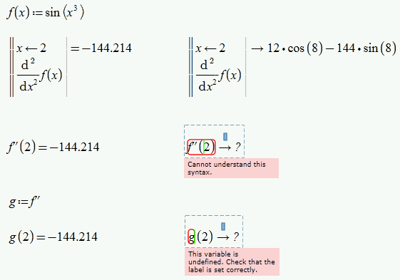

I would like to point out that in Prime, in calculating symbolic derivatives, the order of derivation can not be written as the sum of two integers but with an index that represents the sum of them, and this, however,  is not written properly, in fact:

All OK in Mathcad 15:
The Prime help does not state that the order of the derivative has to be a constant and not an expression to be evaluated, so I consider it a bug (otherwise it would be a severe, not acceptable limitation).
So, while I consider it as a minor one, its still one more reason not to use Prime yet.
@Valery: Yours is not a limitation of Prime, its a mathematical one - it makes sense to limit the order of the derivative to positive integers, so Prime is OK in this case.
If you are looking for other discrepancies or limitations you may look at the newly introduced Prime operator.
It does not exist in real Mathcad (other than in a limited way in a solve block in conjunction with odesolve -> Ctrl+F7).
This Prime operator would be a nice feature, if it would be better visible and could be applied using a keyboard shortcut on foreign keyboards, too. Unfortunately thats not the case and using the ribbon menu is too tedious. This prime symbol can be cascaded to get higher derivatives, too, which is nice.
Unfortunately PTC forgot to tell the symbolics about this new operator
So again - maybe some day this will be a consistent and useful feature, but not yet. Better keep away from Prime - at least for the next few versions.
