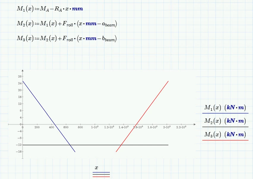

Hi all,
I am goint to make xy-plots of three functions f(x), g(x) and h(x). The function h(x) depends of g(x) which depends of f(x).
I would like to set up for which values of x each function should apply e.g. f(x) for x =A-B, g(x) for x=B-C and h(x) for x=C-D.
How do I do this? Is it easier to put the range on the functions or on the plot?
I am using Mathcad Prime 2.0.
I hope you can help me out.
Thanks in advance.
-Ronnie
Best answer by AlanStevens
Probably slightly better as in the attached, so you get units on the x axis as well.
Alan

hi,
I have had to pull a lot of information out of the sheet as it is confidential, so it doesn't really say much more than the photo I uploaded in the beginning.
I would like to limit the functions so the plots do not continue after an intersection.
-Ronnie
March 15, 2013
Here's one way.
Alan
March 15, 2013
Alan
