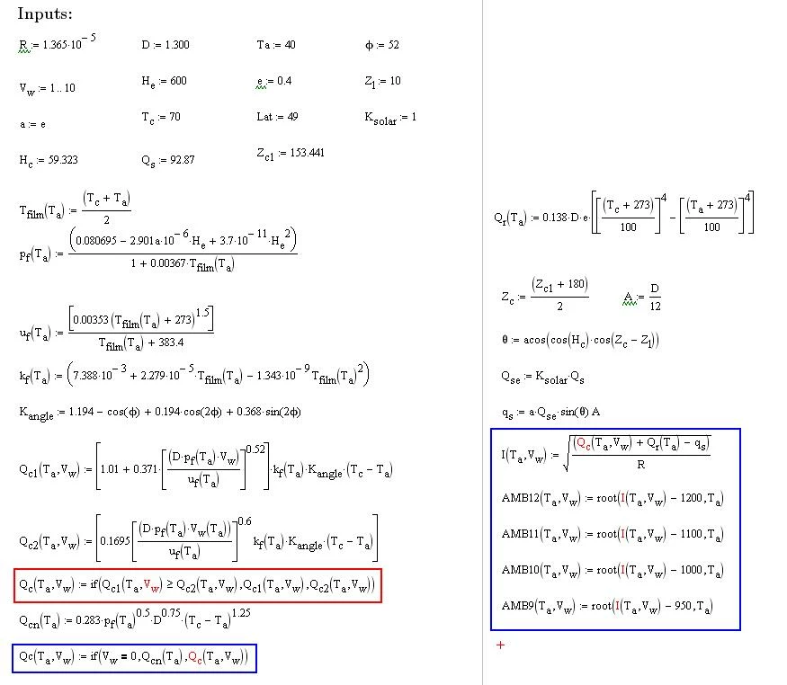

I'm an undergradute EE student who is currently working for a small engineering consultant firm and I've been asked by my boss to create two MATHCAD programs to calculate and graph the ampacity of various conductors. Two variants because one is to be done in "english" units (imperial), and the other in SI units.
So far I've been working off the IEEE Std 738-2006 standard, and have began programming various equations into MATHCAD. While doing so I've come across a few errors that I can't seem to figure out, and I am currently looking for some help in correcting them.
Please see the figure attached for a image of what my program currently consists of. The errors in the blue boxes are solely a consequence of the error in the red box.(From what I can tell) What I can't figure out is why the error in the red box is happening, and how to correct it. For the error in the red box, MATHCAD is telling me the value of Vw must be a scalar. Why is that? How do I fix this?
NOTE: I am currently using MATHCAD 14
I've also attached my most up to date version of the program thus far.
I look forward to any advice/suggestions/comments you guys have.
Thanks again!

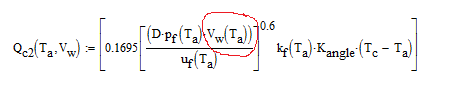

Look carefully at your definition of Qc2. You have defined Vw as a function of Ta there, when it should just be a scalar:
No. Calculations in Mathcad are top left to bottom right. All page boundaries are just to show how it would be printed, and have no effect on calculation order. So Qc is flagged red because at that point in the worksheet the function is undefined.
In Mathcad that is not necessary. Mathcad can handle units. If the worksheet is written in the correct way you could have one sheet that will work with either imperial or metric units (or even a mixture!).
