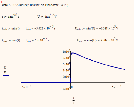

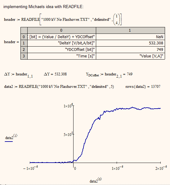

Hello all,
I am trying to figure out how to go about loading data that is stored in a text file into mathcad.
My hope is to make some plots using the data, and perhaps some other calculations.
I've attached one of the data files to this thread so you can observe the format of the data. This contains data measurements from a High Voltage Impulse Generator.
Could someone show me how to do this by means of an example?
Thanks again!
