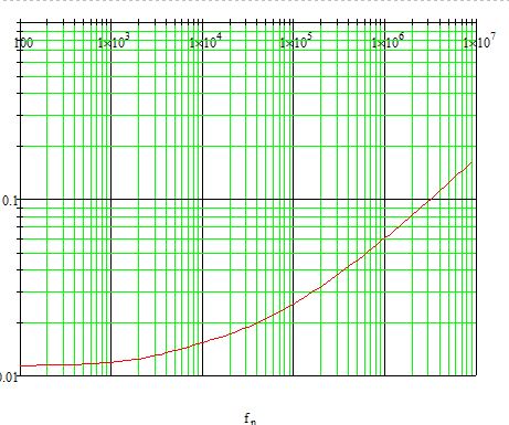

I have a log-log plot. The y-axis range is 0.01 to 1.0. The problem is that the x-axis is labeled at the TOP of the y-axis.
Is there a way (as there is in EXCEL) to change where the x-axis labels are placed (i.e. - I want the labels to be at the lowest y value (on log scale) of 0.01)?

Double-click on the plot, select the "X-Y Axes" tab on the resulting dialog (should be the default tab anyway), then change the "Axis Style" at the bottom of the tab to "Boxed".

version is Mathcad 15.0
I don't know how to add the example, but this is the plot.

Removing the log scale from the Y-axis will also do the job.
Oct 29, 2014 2:46 PM UTC
In Mathcad 15 (and below) there is unfortunately no way to change the point of intersection of the two axis.
This point will normally be (0/0) or (if zero is not in the range shown) the values closest to zero.
In case of a log plot the 0 is exchanged for 1 and the point of intersection tries to be at (1/1).
In case of your plot the intersection point is (100/1).
I guess you may like the view when you change Axis Style from Crossed to Boxed:
