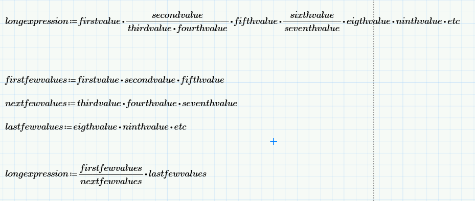

March 11, 2013
Rizford dela Cruz wrote:
How about if the long equation only has multiplication and division operators, how can we perform this?
Are you looking for something like this?
Alan
