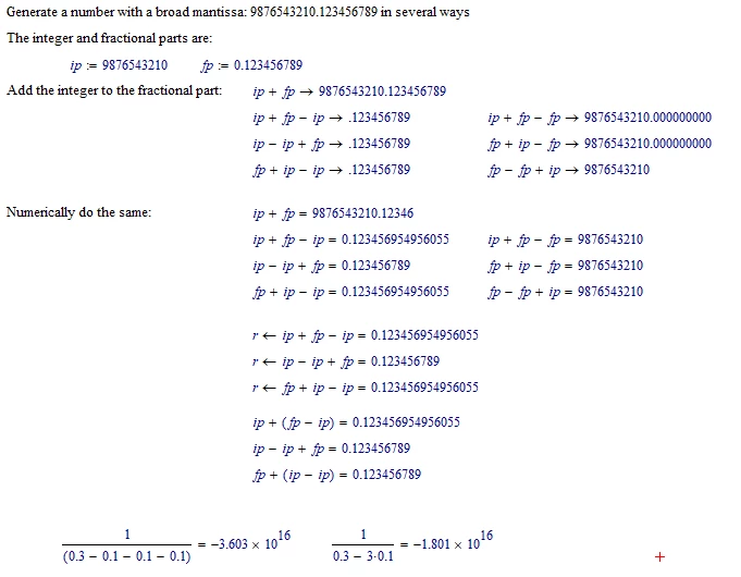

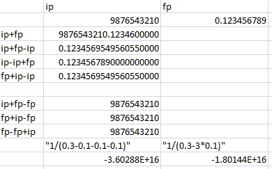

Both Mathcad and Excel make it easy to generate numerical results with floating point error.  For example, try calculating 1/(0.3-0.1-0.1-0.1) in Mathcad and Excel (you'll get a surprising result).
You need a full computer algebra system (like Maple) if you want truly numerically accurate results

When it come to Mathcad its ability to be able to deal with units sure is a huge plus!
When it comes to numerical accuracy I wouldn't expect any big differences as both use the IEEE format for that.
But Mathcad may have better and more stable numerical algorithms implemented (not sure about this as I never would use Excel for any scientific or engineering calculations) and in Mathcad you have the option to use its symbolic calculations as well (even thought they can't compete with Maple or Mathematica).

Without having access to the actual implementations of both the Excel and the Mathcad RK routines it will be hard to pinpoint what went wrong, and whether updates (may) have resolved it.
As far as I can tell, given the same sequence of calculations, both Mathcad (11) and Excel (2007) give the same results.
Well, there's no symbolic in Excel. So numerics only:
All this to demonstrate that to implement a numerical (approximation) algorithm requires careful attention when big and small numbers are both into play...
