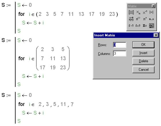

Hello!
Other way to insert a loop "for" is a combination of keys: Ctrl + Shift + "
June 23, 2011
Do you know this properties of the for loop?
June 23, 2011
Nice simple examples Valery, I suggest the thread creator look through the help or quicksheets.
